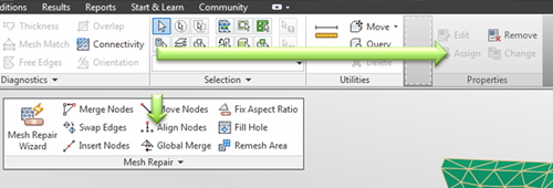

As shown in the image below, these toolbars now appear as permanent tabs alongside the Home tab.
- Undock and move
- You can undock and move the panels within a tab to a different location on the tab, or into the model window if you prefer. Simply click on the title of the panel and drag. To return the panel to the tab, just drag it back again. You can even keep the panel in the model window and change tabs, and when you drag the panel back up to the ribbon, it will return to its original tab.
