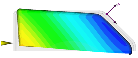

Local coordinate systems (LCS) simply defines new coordinate directions for the results. The following figure shows an example of using an LCS. The LCS is on an angled wall. The Z-deflection results are displayed and assigned to use the LCS rather than the global system. The LCS does not zero out the results like the first anchor location does.

LCS used on beveled wall with a Z-deflection plot
