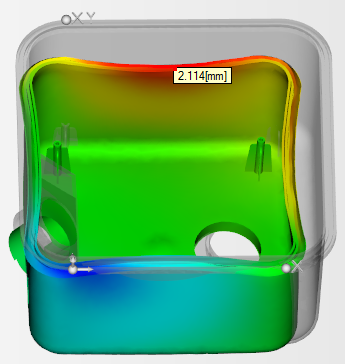

The command Result tab > Examine panel > Examine is used to determine the deflection at specific locations on the model. The following figure shows the deflection at a location selected on the part.
Examine value for the part
The examine command opens the Deflection Query dialog, which provides a breakdown on information for the node selected. When two nodes are selected, the distance between them is evaluated.
