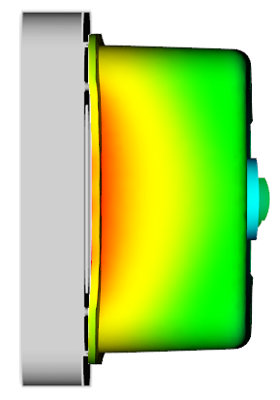

In the image below, the part is assembled with 4 screws, (not shown). Three of the four screw bosses are used to define the anchor plane and the sealing surface is evaluated relative to the mating part.
