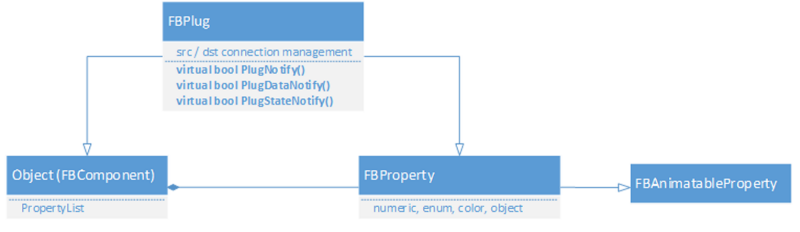

FBPropertyEventCallbackSynPoint OnSynchronizationEvent;Most of the SDK object classes are inherited from the FBPlug class, which provides a set of low level functions to manage the source (child) and destination (parent) connections between the plug instances. It also provides three important virtual functions: FBPlug::PlugNotify(), FBPlug::PlugDataNotify(), and FBPlug::PlugStateNotify(). These functions can be overridden in the subclasses to receive notifications when there are changes in the internal state of the instances.
The following figure shows the plug based object model in MotionBuilder:
The most important subclasses are FBComponent and FBProperty. An instance of FBComponent owns a list of properties (FBComponent::PropertyList). The connection between the two object instances and the various value (or state) changing events on owned properties trigger callback events in the PlugNotify() (or PlugDataNotify() and PlugStateNotify()) function. The FBProperty subclass can contain various type of raw data (FBPropertyBool, FBPropertyInt, FBPropertyColor, and others), and it also provides a uniform mechanism to organize the object’s attributes either using scalar or time varied (FBAnimatableProperty) values.
Most objects in the ORSDK (including model, locator, geometry, material, textures, and others) are inherited from the FBComponent class. The following figure shows the model, locator, geometry, material, and texture class hierarchy.

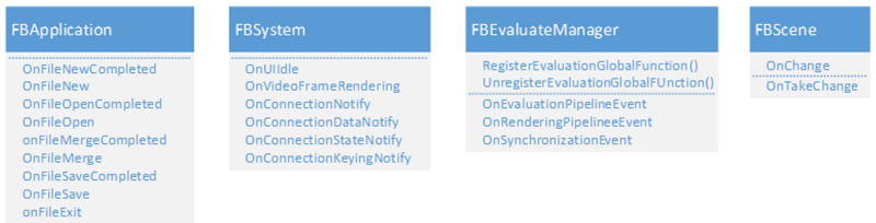

You can use a set of callback events (type of FBPropertyEvent and its subclasses) in some global singleton objects to write code that can listen to the following:
You can use wildcard searching (FBPropertyEvent*) in the ORSDK header files to collect the complete list of event properties. The following figure shows the frequently used event properties in singleton objects.
