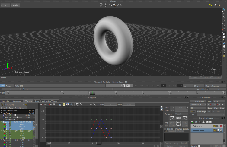

Example: Animating a Camera
Sample Viewport and FCurve Editor Output:
Program Summary: The program below creates a torus (FBModel), and a camera (FBCamera) with motion blur enabled. The program uses the scene's camera switcher (FBCameraSwitcher) to switch the viewport's perspective to the newly created camera. An animated translation around the torus is then applied to the camera using one of two methods:
