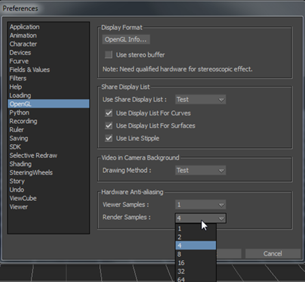

You can choose different hardware anti-aliasing sample counts for viewport and file rendering as shown in the following figure.

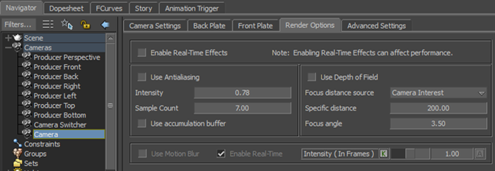

You can achieve advanced offline rendering effects either through multi-pass or super sampling techniques.

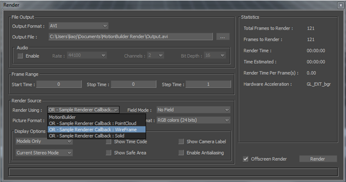

The offline rendering interface is updated. You can select the custom renderer and its preset, if available in the Render Using drop-down list for rendering an image sequence or video format. This can also be done using the SDK.
