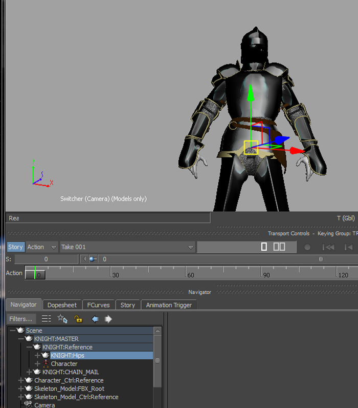

  2. Select the skeleton hips in the Knight character. You can see that it does not contain any animation.

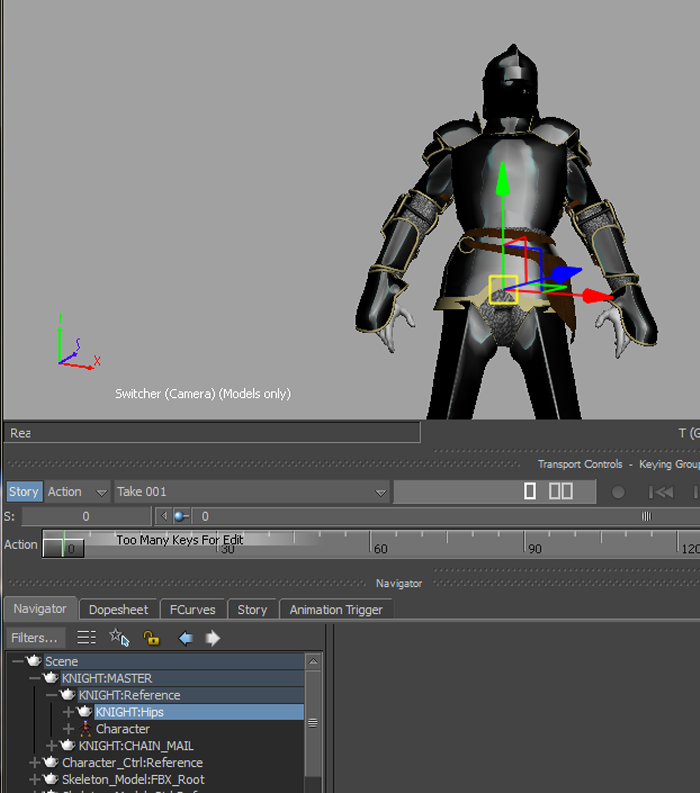

  3. Run the plot_animation_from_story_to_character.py script. It plots the animation from the story to the character’s skeleton. Now, you can see the animation in the character's hips.
You can also plot the animation to the character's control rig using FBCharacterPlotWhere.kFBCharacterPlotOnControlRig.
