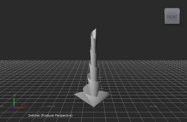

Example: Spiral Mesh
Sample Viewport Output:
Program Summary: The program begins by creating a spiral mesh object. The spiral mesh object is then assigned to the geometry of an FBModelCube (FBModel.Geometry), effectively replacing the cube's mesh with the spiral mesh.
from pyfbsdk import *
import math
# Helper Function(s).                                         #
# Generate a list of vertices which will define a spiral.
def createVertices(pWidth, pHeight):
    vertices = []
    # Our first vertex will be centered at the origin.
    vertices.append(FBVector3d(0,0,0))
    # The rest of the vertices will form the spiral.
    for t in range(pHeight / (pWidth * 2), pHeight):
        x = pWidth * math.cos(0.25 * t) * 1/float(t) * pHeight
        y = t
        z = pWidth * math.sin(0.25 * t) * 1/float(t) * pHeight
        vertices.append(FBVector3d(x,y,z))
    return vertices
# Create a spiral mesh using the width and height parameters.
def createSpiralMesh(pWidth, pHeight):
    # Obtain a list of vertices defining a spiral.
    spiralVertices = createVertices(pWidth, pHeight)
    numVertices = len(spiralVertices)
    # Create an empty mesh object.
    mesh = FBMesh('mySpiralMesh')
    # Always call GeometryBegin() / GeometryEnd() in pair when editting geometry.
    mesh.GeometryBegin()
    # Initialize all the vertices inside the mesh object and
    # add the (x, y, z) coordinate of each spiral vertex into the mesh.
    mesh.VertexInit(numVertices, False, True, True)
    for vertex in spiralVertices:
        mesh.VertexAdd(vertex[0], vertex[1], vertex[2])
    # Define the polygons as a series of triangles to form the spiral.
    for i in range(2, numVertices):
        # Begin a new polygon.
        mesh.PolygonBegin()
        # The argument of PolygonVertexAdd() is the corresponding vertex inside the mesh.
        mesh.PolygonVertexAdd(0)
        mesh.PolygonVertexAdd(i-1)
        mesh.PolygonVertexAdd(i)
        # End the polygon.
        mesh.PolygonEnd()
    # Compute the clockwise normals, as indicated by the True argument.
    mesh.ComputeVertexNormals(True)
    # Finish the geometry editting.
    mesh.GeometryEnd()
    return mesh
# Main.                                                       #
# Clear the scene.
FBApplication().FileNew()
scene = FBSystem().Scene
# Create a spiral mesh which we will assign to a model.
spiralWidth = 5
spiralHeight = 150
spiralMesh = createSpiralMesh(spiralWidth, spiralHeight)
# Create a model, whose mesh we will replace by the spiral.
model = FBModelCube('myModel')
model.Geometry = spiralMesh
model.Show = True
