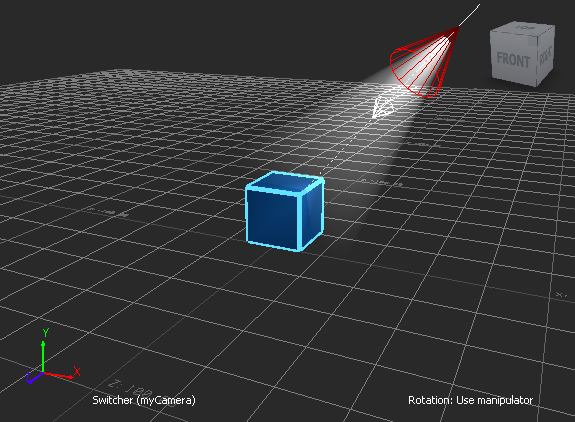

Example: Adding Objects to the Scene
Sample Viewport Output:
Program Summary: The following program presents a broad overview of how to add various objects to the scene, including cameras, lights, materials, shaders, i/o devices, and constraints.

# Create a camera looking at the model.
def createCamera(pModel):
    # FBCamera() adds a camera to the scene's list of cameras.
    # We use the camera switcher to change the view to our own camera.
    camera = FBCamera('myCamera')
    camera.Translation = FBVector3d(85, 80, 180)
    camera.Show = True
    # Set the camera's interest point to the model.
    camera.LookAt = pModel
    # Enable camera switching.
    scene.Renderer.UseCameraSwitcher = True
    # Set our view to the newly created camera.
    cameraSwitcher = FBCameraSwitcher()
    cameraSwitcher.CurrentCamera = camera
    return camera
# Create a light pointing at pModel.
def createLight(pModel):
    # FBLight() adds a light to the scene's list of lights.
    # The light will be parented to the cube - when the cube moves, so will the light.
    light = FBLight('myLight')
    # Make the light a spotlight.
    light.LightType = FBLightType.kFBLightTypeSpot
    light.Intensity = 100                          # Value between 0 and 200
    light.ConeAngle = 50                           # Value between 0 and 160
    light.FogIntensity = 50                        # Value between 0 and 200
    light.DrawGroundProjection = False             # Don't show the light on the ground.
    # Point the light at the model.
    light.Parent = pModel                          # Set the light's parent model.
    light.Translation = FBVector3d(60, 75, 30)     # The light's local translation from its parent.
    light.LookAt = light.Parent                    # Point the light at the parent.
    light.Show = True                              # Show the light in the scene.
    return light

# Output.                                                     #
Scene graph:
Scene - FBModel
	myCube - FBModel
		myLight - FBLight
	myCamera - FBCamera
Scene contents by type:
Materials
	DefaultMaterial: FBMaterial
	myMaterial: FBMaterial
Shaders
	Default Shader: FBShaderLighted
	myShader: FBShader
Cameras
	Producer Perspective: FBCamera
	Producer Front: FBCamera
	Producer Back: FBCamera
	Producer Right: FBCamera
	Producer Left: FBCamera
	Producer Top: FBCamera
	Producer Bottom: FBCamera
	myCamera: FBCamera
Lights
	myLight: FBLight
Devices
	myKeyboard: FBDevice
Constraints
	Shot Track: FBStoryTrack
	myConstraintRelation: FBConstraintRelation
