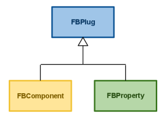

FBPlug - The Connection Management Base Class.
The FBPlug class is the base class of FBComponent and FBProperty. The FBPlug class is responsible for managing the connections among components and properties. There are two types of connections:

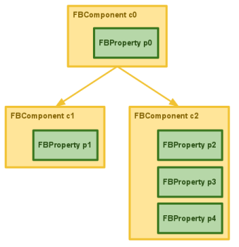

Connection Example
The diagram below illustrates the source-destination relationships among components, and the owned-owner relationships among components and properties.
Accessing the source components of c0.
# Assume c1 is indexed at 0.
c1 = c0.GetSrc(0)
# Assume c2 is indexed at 1.
c2 = c0.GetSrc(1)
Accessing the owned property of c0.
p0 = c0.GetOwned(0)
Accessing the destination component of c2.
c0 = c2.GetDst(0)
Accessing the property p4 from property p1.
# A property can only have one owner.
c1 = p1.GetOwner()
# Assume c0 is indexed at 0.
c0 = c1.GetDst(0)
c2 = c0.GetSrc(1)
# Assume p4 is indexed at 2.
p4 = c2.GetOwned(2)
