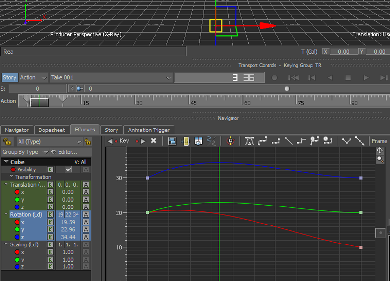

Run the create_animation_on_cube.py script in the Python Editor to get a simple FCurve.
Following are the points to keep in mind:

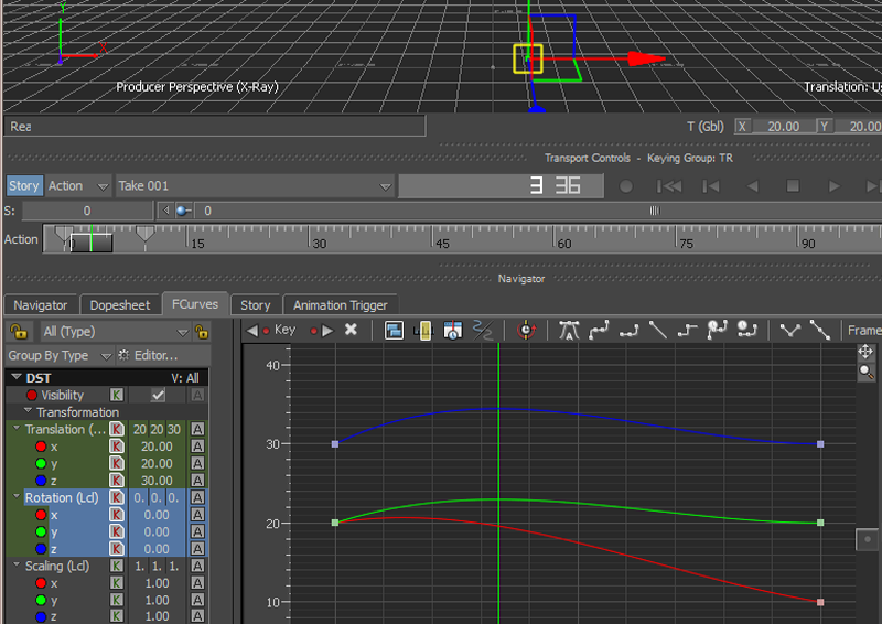

Keep the last scene open, and then run the copy_animation.py script to copy the animation from the Cube and create a new cube called DST.

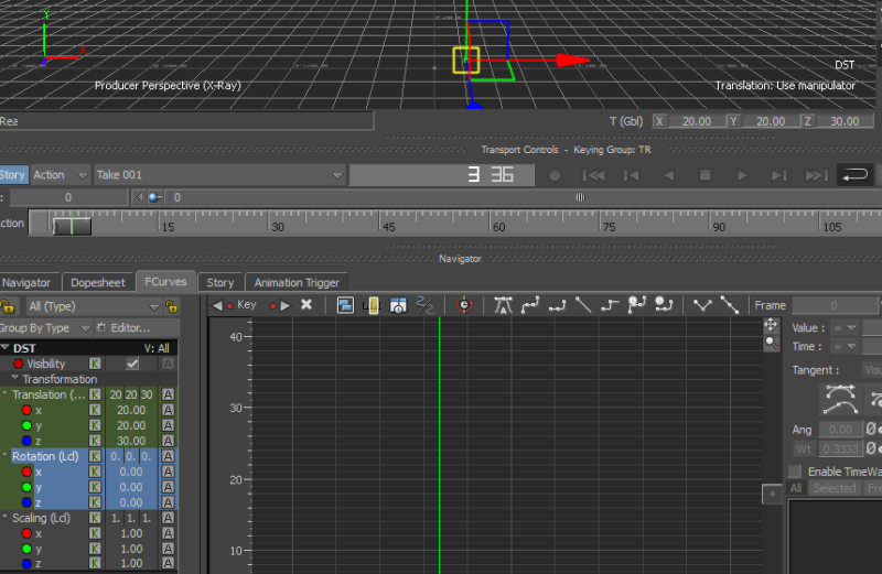

Keep the last scene open, select the DST object, and run the clear_animation.py script to clear the selected animation.
