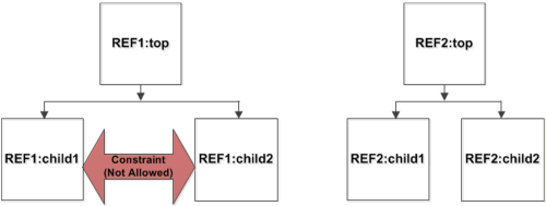

Connections Between Referenced Items
Connections between items within a referenced object are not allowed because these
connections are not recorded by MotionBuilder.

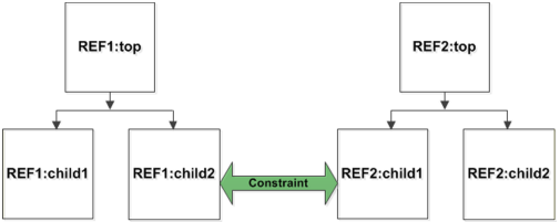

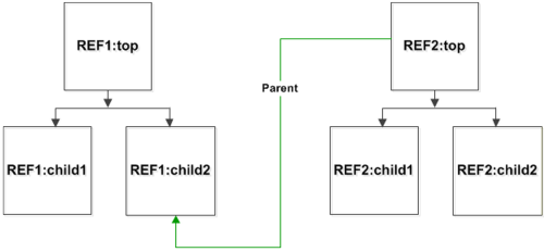

The following figures illustrate the connections that are allowed.
- This figure shows an allowed constraint.
- This figure shows an allowed parent connection.

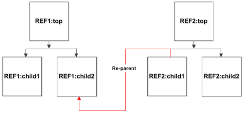

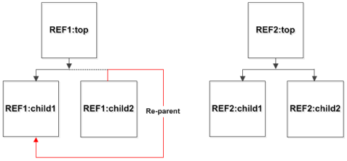

The following figures illustrate the connections that are not allowed.
- This figure shows a constraint that is not allowed.
- This figure shows a re-parent connection that is not allowed.
- This figure shows another re-parent connection that is not allowed.
