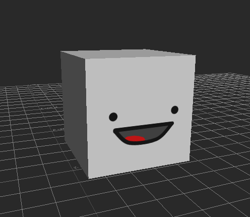

Texture File and Location: C:\<user>\Documents\MB\Face.png
Program Summary: The program below creates a cube model, and creates a texture from the 'Face.png' file contained in the current user's My Documents folder. It then associates the texture to a new material's diffuse channel, and appends the material to the model.
from pyfbsdk import * import os # Get the texture file residing in the current user's My Documents\MB folder. myDocuments = os.path.expanduser('~') + '\Documents\MB' textureFilename = 'Face.png' textureFullPath = os.path.join(myDocuments, textureFilename) ############################################################### # Helper Function(s). # ############################################################### # Create a sphere primitive from the asset browser. def createModel(): model = FBCreateObject( 'Browsing/Templates/Elements/Primitives', 'Cube', 'Cube' ) model.Name = 'myModel' model.Translation = FBVector3d(0, 75, 0) model.Scaling = FBVector3d(2, 2, 2) model.Show = True return model # Create a layered texture, assign it to the diffuse channel # of a material, and apply the material to the model. def applyTextureToModel(pTextureFullPath, pModel): # Create a texture and set its mapping type. texture = FBTexture(pTextureFullPath) texture.Mapping = FBTextureMapping.kFBTextureMappingXY # Associate the new texture to the diffuse channel of a new material. material = FBMaterial('myMaterial') material.SetTexture(texture, FBMaterialTextureType.kFBMaterialTextureDiffuse) # Append the material to the model's list of materials. pModel.Materials.append(material) ############################################################### # Main. # ############################################################### # Clear the scene. FBApplication().FileNew() # Create a model to which we will apply a texture. model = createModel() # Create a texture object using the texture path declared at the top of this file, # and apply it to the model. material = applyTextureToModel(textureFullPath, model)
