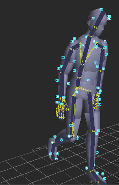

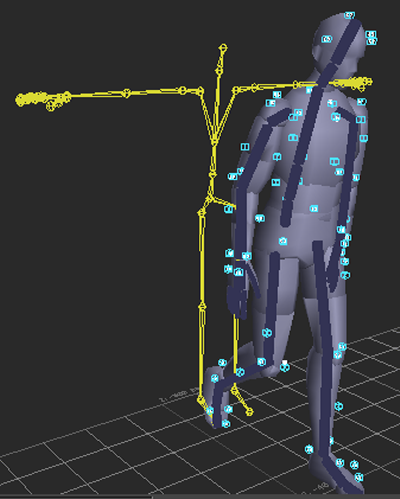

  1. Create a skeleton from the actor. CreateSkeletonForActor(pActor,pPrefix) creates a skeleton as shown in the following figure.

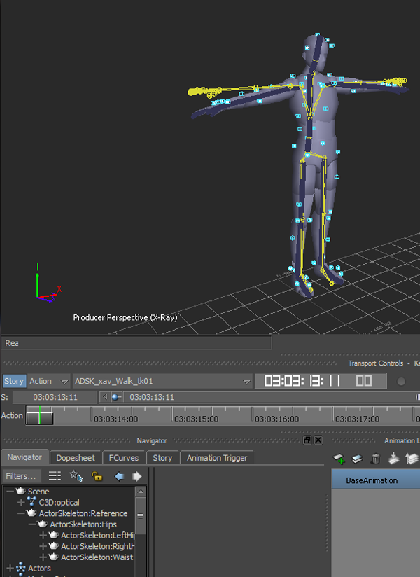

  3. Prepare for snap.

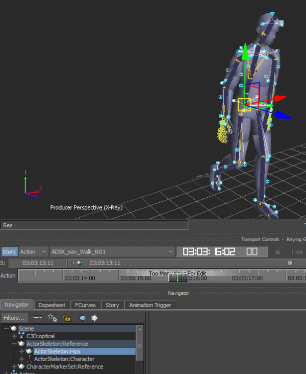

    1. Move the cursor forward so that the skeleton is not following the actor.
    2. Run ApplyStateFor(lChar, pActor.GetCurrentSkeletonState(False)) to link the current state of the actor to the current state of the character. Then, the skeleton must be driven using the actor.

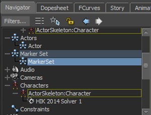

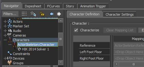

  4. Snap markers on the character marker set. Initially, there is no marker for the character as shown in the following figure.

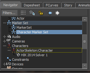

    CopyMarkerMappingFromActorToCharacter(lChar, pActor) creates a marker set for the character, then snaps the actor’s markers to the character’s marker set. It uses lMarkersProp.ConnectSrc(lMarker) to connect the character's marker property with the actor’s marker. The actor’s marker is the driving source. The character marker set is shown in the following figure.

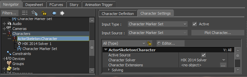

  5. Set the character marker as the input. Then, set the character's input to its character marker set that is created in the previous step, and set the input as active.
