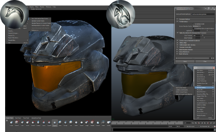

You can export your work from Mudbox and quickly import it into Maya, 3ds Max or Softimage using
File > Send to
[Autodesk product].
Send to
exports from Mudbox using the Autodesk® FBX® file format. See also
Export a Mudbox model using FBX.
The
Send to options are designed support a common, iterative, round-tripping workflow that lets a production start with a scene in a content creation application (Maya, 3ds Max, or Softimage), export the content to Mudbox for added paint or sculpting detail, then merge back to the original scene.
