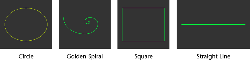

Curves
Creates a 2D curve on the view plane based on pre-defined geometric shapes. Select from the following default curve shapes:
