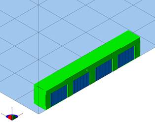

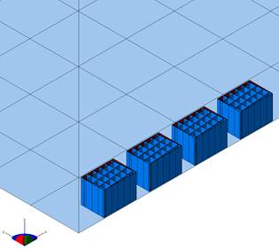

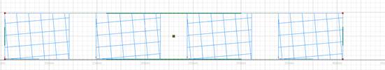

The following figures show examples of compatible box type supports, and an example layer slice of the supports. These can be easily generated using Netfabb with the provided automated support script box_type_no_fragments.support.
Box type supports on STL
Box type supports
Box type layer slice
