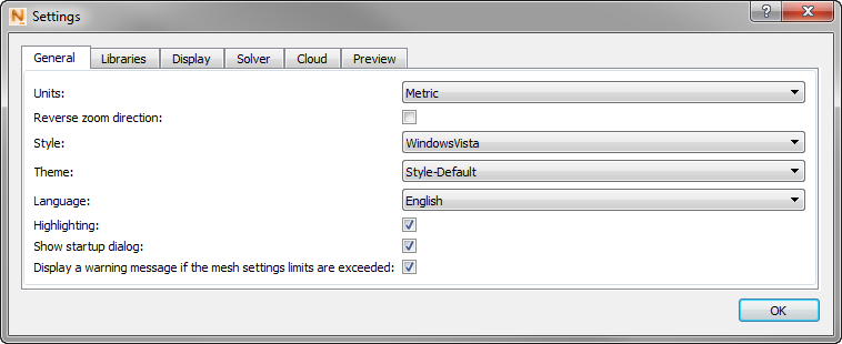

General tab
- Units - Change the system of units if desired. The solver system of units, metric, (kg/mm/s) is defined on the
Units reference page. SI (kg/m/s) and US-English systems of units (lb/in/hr) can also be used.
- Reverse zoom direction - by default scrolling the mouse wheel towards your hand zooms out. Checking this box reverses this.
- Style,
Theme, and
Highlighting control the visual appearance of the user interface. The Style settings enable you to replicate common appearances such as Motif and Windows XP.
- Show startup dialog - by default this option is checked, which brings up the splash screen upon startup.

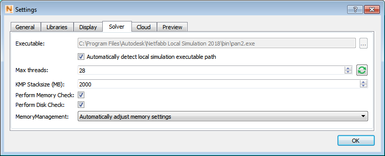

Solver tab
Use these settings to control various aspects of the solver behavior:

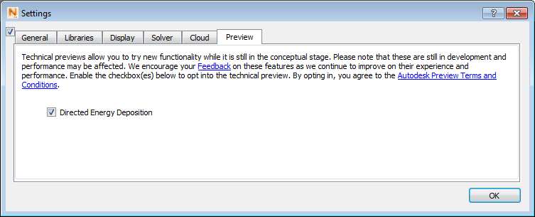

Preview tab
If present, this tab allows you to enable new functionality that is under development in the product. In so doing, you are invited to submit comments to the developers about your experience with the new features. These functions are only available for users with a licensed version of
Autodesk Netfabb Local Simulation.
