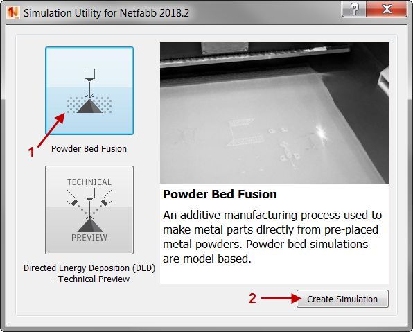

  1. Click Simulation menu > New.
  2. In the dialog that opens, click Powder Bed Fusion and then Create Simulation.

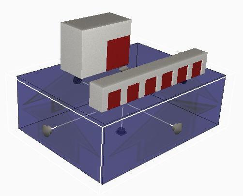

  3. In the Import Model dialog, browse to the sample files subfolder Example_8, and open part1.stl. In the Import dialog, specify that this is a part, not a support structure.
    You will open three more files from this folder.
  4. Click Home tab > Import, and open the file part2.stl, again specifying it as a part.
    The build plate expands to accommodate both parts.
  5. Open support1.stl. In the Import dialog, select Support Structure, and set the Volume Fraction to 0.3.
  6. Open support2.stl. In the Import dialog, select Support Structure, and set the Volume Fraction to 1.0.
  7. Click Home tab > Build Plate > Size tab and expand the build plate in X and Y directions to be a bit wider than the parts.

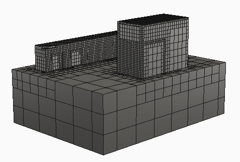

  8. Click Home tab > Mesh Preview and save the project.
    Note how the size of the mesh elements varies by location. This shows the adaptive meshing which decreases the number of degrees of freedom required to solve the problem.

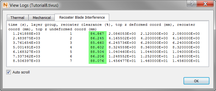

  10. Click Results tab > View Logs > Recoater Blade Interference tab.
    Note the high values for recoater clearance (highlighted), indicating that the support structures were keeping distortion to low levels. The default value for Recoater Tolerance is 80%. Recoater Tolerance is a user defined value, set in the Solver Settings dialog, which specifies how much risk is accepted when predicting possible recoater interference. The lower the value, the higher the threshold is for issuing a recoater warning. Higher values will issue more recoater warnings. Consult the Recoater Tolerance page for further information.

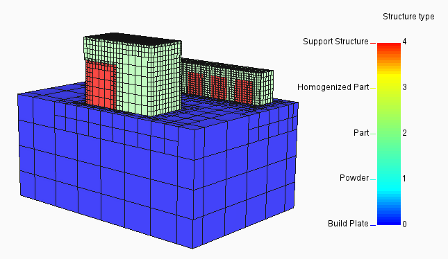

  11. In the Browser, in the Results section, turn on Structure type.
    Here you can see that the build plate, parts, and support structures are clearly marked.

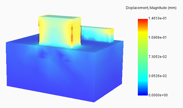

  12. In the Browser Results, turn on Displacement and play through the animation.

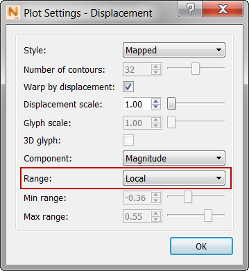

  13. Click Results tab > Plot Settings and ensure that the Range setting is Local.
    Playing through the results shows the development of distortion during powder bed processing.
    For a clearer display, as shown, you may want to right-click Displacement in the Browser, select Render Properties, and turn off Element Edges.
