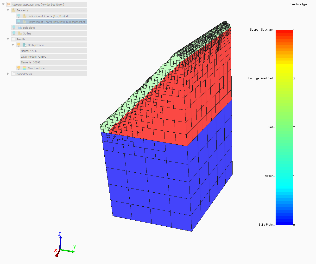

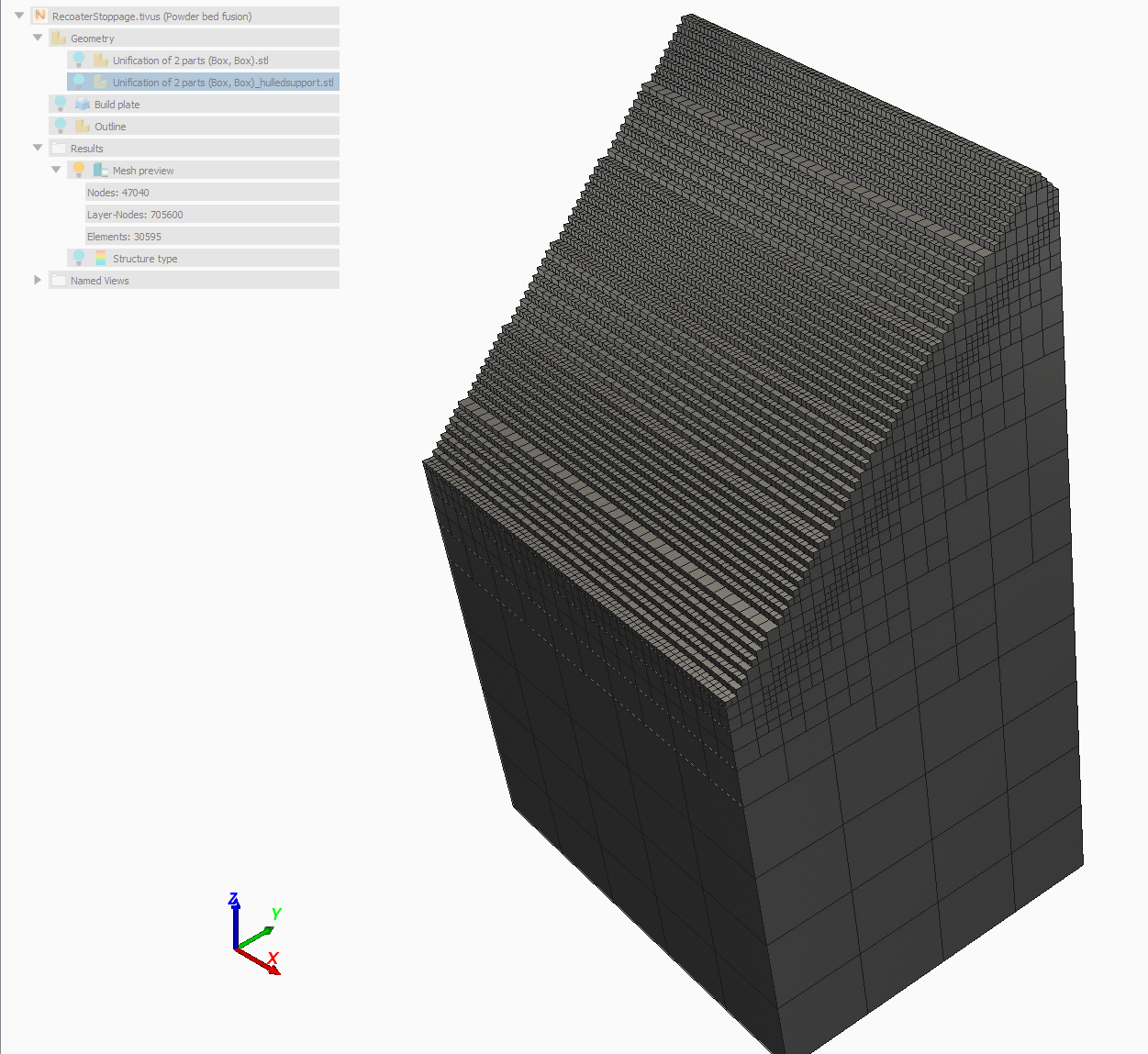

Mesh Preview
Click to generate a mesh preview of the active part and build plate. If the project has not already been saved, a prompt will appear to save the project before the mesh preview is begun. Performing a mesh preview is useful to ensure the mesh settings chosen create a voxel mesh that adequately captures the geometry of the part before committing to a full simulation. Mesh settings should be chosen so that the thinnest geometric feature has at least 2 elements through its thickness to ensure that the part can freely distort during simulation. Good FE practice includes performing a mesh convergence study for each geometry. Details about mesh settings and instructions on calculating mesh convergence can be found on the Mesh Settings page.
The Clipping option on the View ribbon can be useful to investigate the mesh quality after preview. In the tree navigator below the Mesh Preview icon, mesh metrics for the number of Nodes, Layer-Nodes (number of nodes X number of simulated layer groups), and Elements are given, which can be used to estimate complexity of a simulation using the current mesh settings.
Mesh Preview results include the Structure type which can be used to ensure the proper settings and conditions have been selected.
