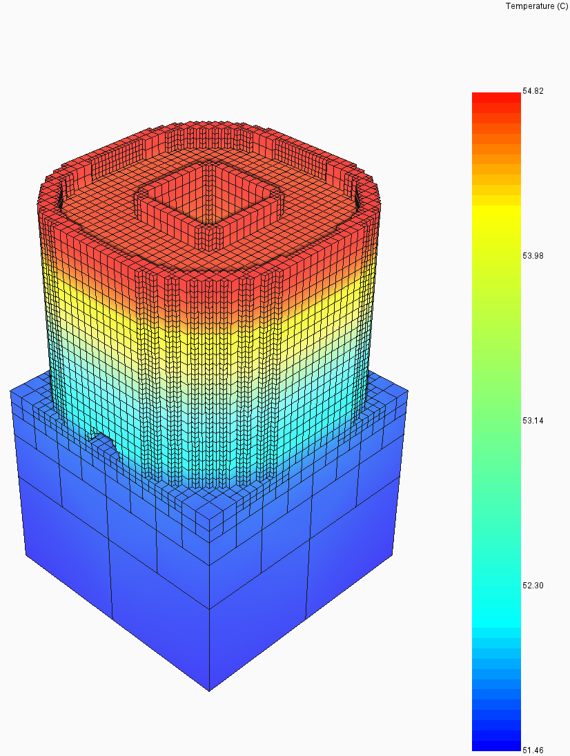

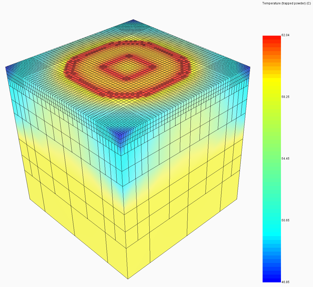

The table below presents a comparison of simulating the same part with uniform heat loss and conduction to loose powder. showing the thermal results after the last deposition layer, mesh details, and run times. This illustrates the trade offs between increasing model accuracy with improved thermal boundary conditions and the computational demands of the solver.
Uniform Heat Loss Conduction to Loose Powder
33086 Nodes
15856 Elements
727892 Layer-Nodes
67751 Nodes
46668 Elements
1490522 Layer-Nodes
44 second thermo-mechanical runtime on 14 core machine 72 second thermo-mechanical runtime on 14 core machine
