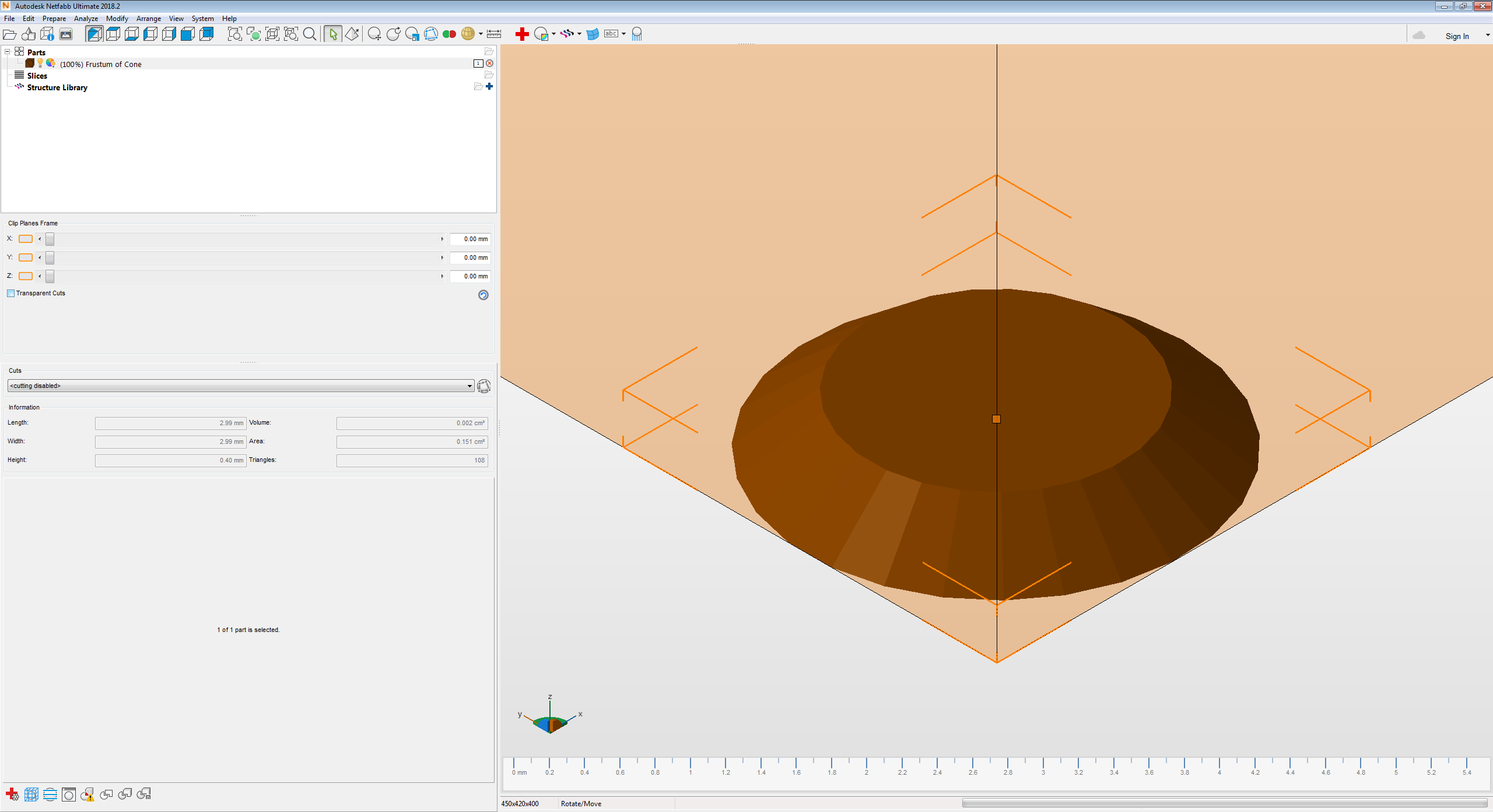

  2. Click File > Add Part and from the sample files subfolder Example_20, import the file Frustum of Cone.stl as shown below:
  3. On the Project Tree, Parts node, drag and drop the Frustrum of Cone file into the Slices function. The Slice Part dialog opens.

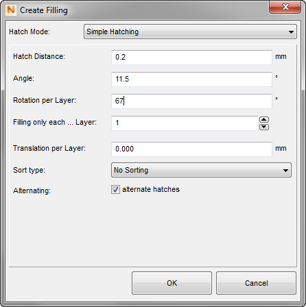

  6. Under Project Tree, Slices node, right-click Frustrum of Cone, then select Extras > Create Filling.
  7. In the Create Filling dialog, set the following values:
    • Hatch Distance: 0.2 mm
    • Angle: 11.5°
    • Rotation per Layer: 67°
    Leave the other options at default values, and click OK.

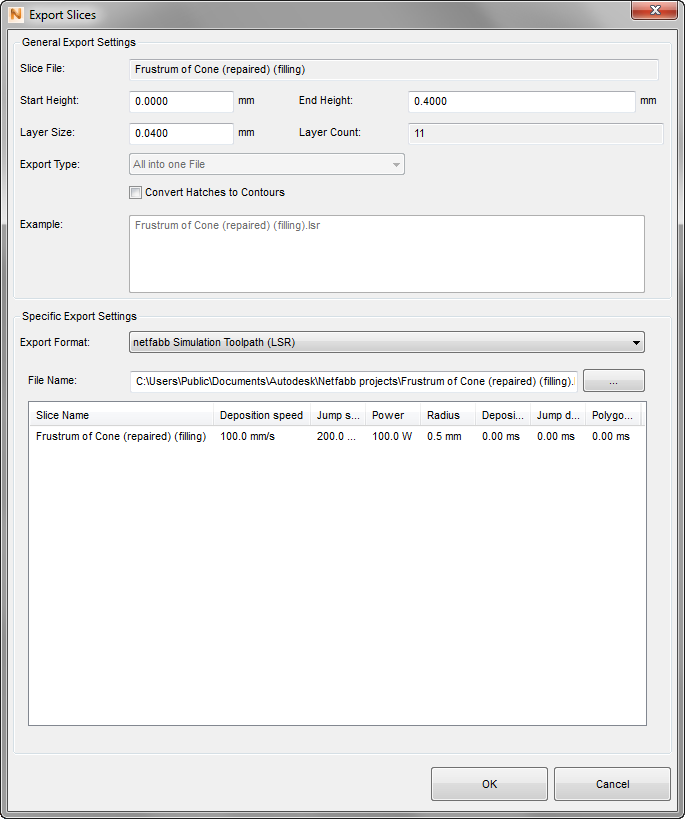

  9. Under the Slices node, right click the Frustrum of Cone (filling) item that was created in the last step, and select Export > as LSR. The Export Slices dialog opens.
  10. In the File Name field, specify a suitable directory and name for later use of the LSR file.

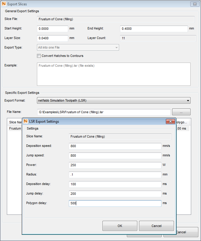

  11. In the large field below File Name, double-click the name under Slice Name to open the LSR Export Settings dialog. Adjust the settings as follows:
    • Deposition Speed: 800 mm/s = rate at which laser is rastered
    • Jump Speed: 800 mm/s = travel speed of laser between laser passes
    • Power: 250 W = Nominal laser power
    • Radius: 0.1 mm = Melt pool radius, nominally equal to laser diameter
    • Deposition Delay: 100 ms = Interlayer dwell time
    • Jump Delay: 200 ms = Dwell time between laser passes
    • Polygon Delay: 500 ms = Dwell time added after directional changes
  12. Click OK to accept these options, then click OK in the Export Slices dialog to save the LSR file in the specified directory.
