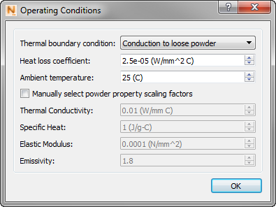

  4. Open Operating Conditions and set Thermal boundary conditions to Conduction to loose powder. Click OK.

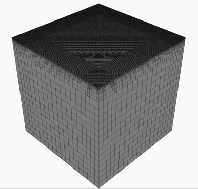

  10. The following mesh appears:
    This mesh has 122 million layer-nodes and 957 thousand nodes, as recorded on the Mesh preview item in the Browser. This far exceeds what Simulation Utility LT can run. If desired, this model can be submitted to solve on the Autodesk Cloud using Autodesk Cloud Credits, by clicking Solve > Solve on cloud.

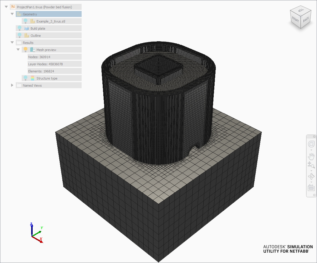

  11. Return to Operating Conditions and revert the Thermal boundary conditions setting to Uniform heat loss.
    This setting changes the thermal boundary conditions on all surfaces of the model and base plate to a uniform heat loss value of 25 W/m °C. This value has been shown to give a good approximation of thermal losses into the surrounding powder. Using this boundary condition also significantly reduces the number of elements and nodes, as the powder elements are all removed, leaving just the component and base plate to be meshed.
  12. Press OK to accept, and press Mesh Preview again to see if this brings the model within the acceptable meshing limits. Since a mesh already exists, a prompt will ask to overwrite those results. Press Yes to proceed.
    The meshing operation should take far less time. However, the resulting mesh, as indicated by the pop up error notifications, is still too dense, with 46 million layer-nodes. The number of nodes has fallen within the allowable bounds at 361 thousand nodes.

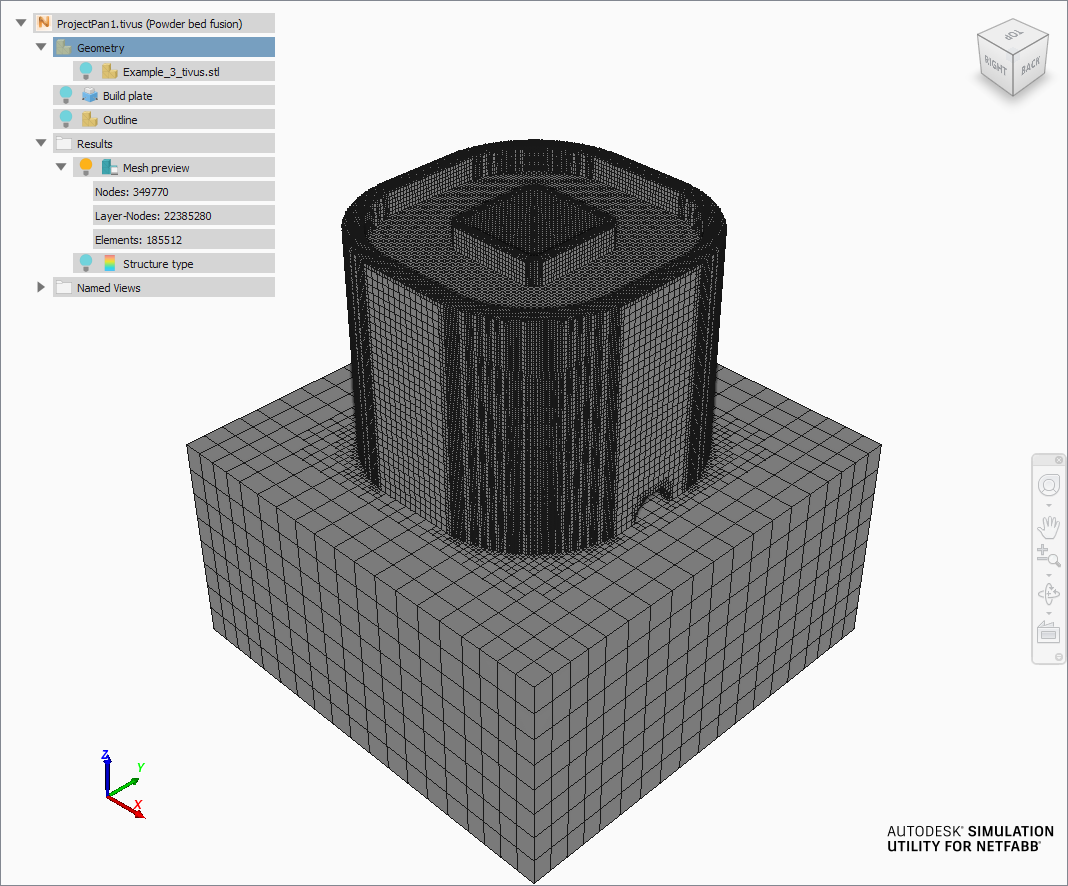

  13. Return to the Mesh Settings menu and set Coarsening Generations to 1. Press OK to accept, and press Mesh Preview again to see if the new mesh setting brings the model within the acceptable meshing limits.
    The resulting mesh is just over the allowable bounds, with 22 Million layer-nodes.

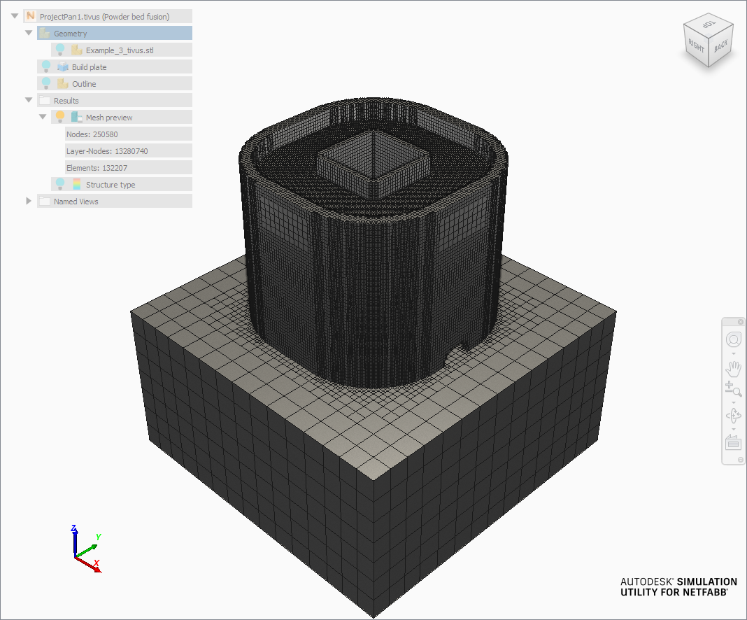

  14. Return to the Mesh Settings menu again and change Layers per Element to 6. Press OK to accept, and press Mesh Preview again to see if the new mesh setting brings the model within the acceptable meshing limits.
    Note upon meshing that neither the Log file nor the error notification pop up yield an Error. This set of operating conditions and mesh settings have brought the mesh settings within the bounds allowed by Simulation Utility LT, with 251 thousand nodes and 13 million layer-nodes. This geometry can now be solved to see how this component develops stress and distortion and various thermal effects using generic Ti-6Al-4V processing conditions.
