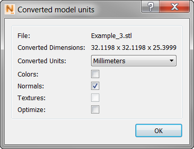

  5. In the Converted model units dialog, ensure that Converted Units are Millimeters and Colors is not selected, then click OK.

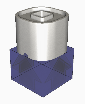

    This imports the STL file and automatically sizes the build plate:

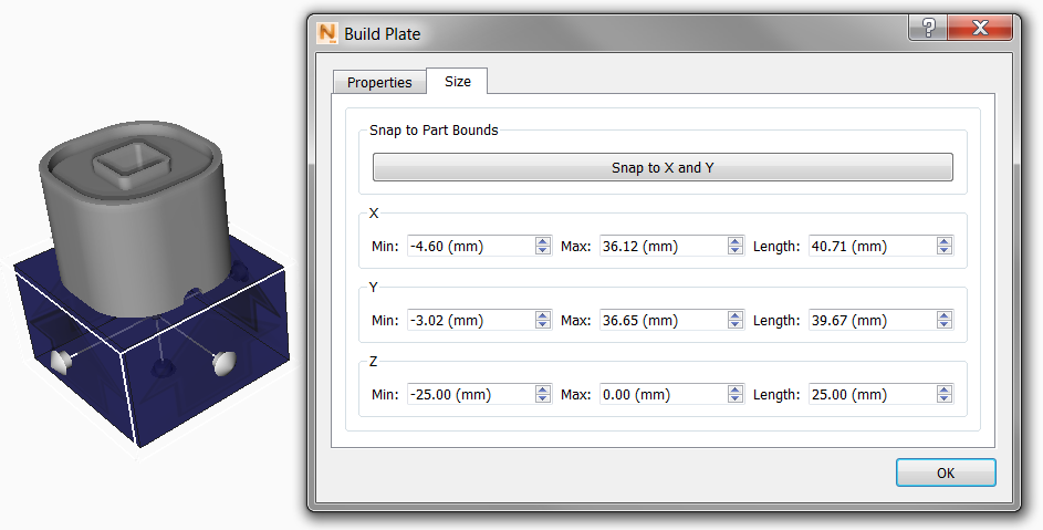

  6. To adjust the build plate size, click Home tab > Plate .
  7. Adjust the size of the build plate, using the handles for X, Y, and Z axes, or the numeric Length settings in the dialog box.
  8. Once finished, click OK to save the build plate changes.

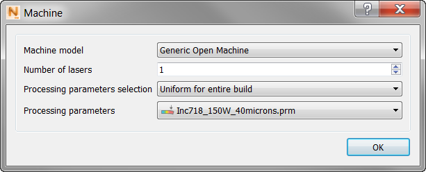

  9. Click Home tab > Machine to open the Machine dialog.
  10. Leave the Machine Model setting at the default Generic Open Machine.
  11. In Processing Parameters, select the PRM file you generated in Tutorial 2, or Inconel 718.

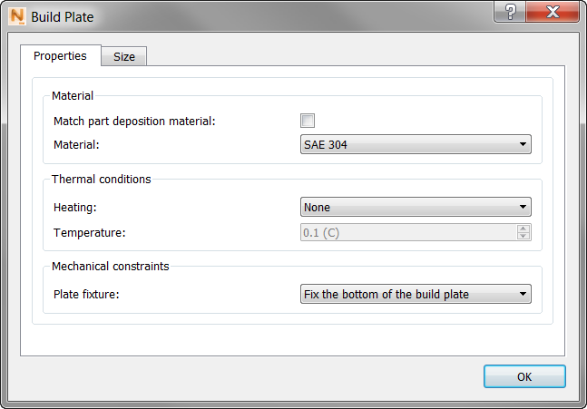

  12. Click Home tab > Build Plate.
    Deselect Match Part Deposition Material, and in the Material menu, select SAE 304 stainless steel, which is commonly used with Inconel powder.
  13. Click OK.

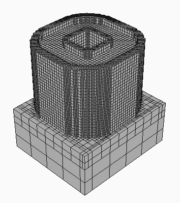

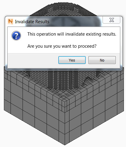

  14. Before attempting a full simulation, check the quality of the mesh by clicking Mesh Preview .

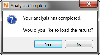

    If you have not already saved your project, you will be asked to do so. Choose a file path that will be easy to find later. After a brief wait, the analysis complete prompt appears.
  15. Click Yes to view the mesh.
  16. Select a Solve option to run the simulation on your computer or on the cloud:
    Note: Your options here may be restricted if you are running Simulation Utility LT, installed with Netfabb Premium or Ultimate. For more information, see About Simulation Utility for Netfabb.
  17. Click Yes to invalidate (update) existing mesh results.

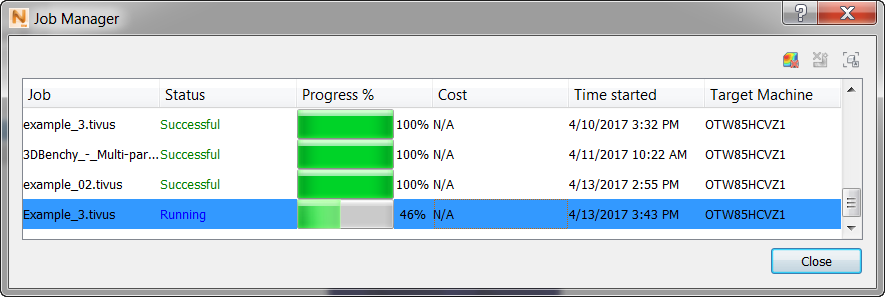

    2. For more detail on the state of current and past simulations, click Job Manager .
      The following dialog appears, which shows some useful details about the job, including Cost in Cloud Credits (if applicable), Time started, and the Target Machine or computer that ran the job.

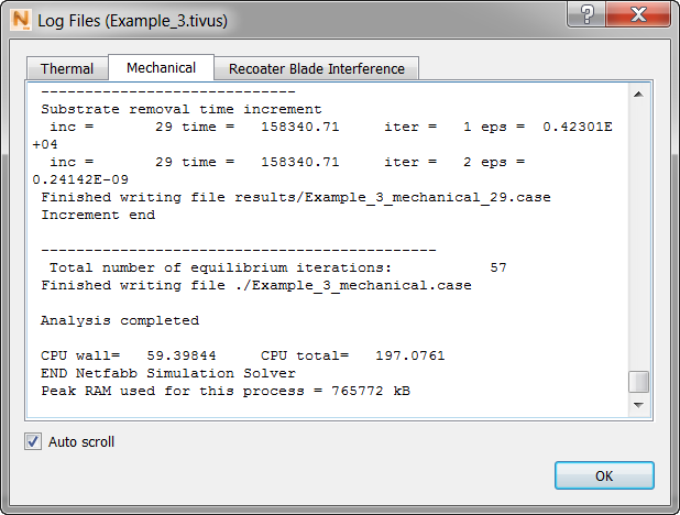

    3. For a deeper look into the progress, pick the View Logs option from the upper right of the dialog, or from the Display panel of the Home tab.
      A window opens to show the solver output files in real time. Three tabs at the top, Thermal, Mechanical, and Recoater Blade Interference, report on different aspects of the simulation.
    This log displays simulation status details, including the current layer group being solved, the total number of layers to be solved, number of nodes, elements, and equations for each increment, increment number, time, iterations per increment and their associated residuals.
    Any warnings or errors during the simulation are displayed in this window. The end of each simulation phase log states the following details:
    • "Analysis complete" message
    • Total warnings recorded (if applicable)
    • CPU wall time in seconds, which is the actual time required to finish the simulation
    • CPU total time in seconds, which would be the time required to finish the simulation for an equivalent single core machine
    It's a good practice to examine the logs at the end of every thermo-mechanical simulation; not only will they inform you about errors in the simulation, but if serious build failure mechanisms occur such as recoater blade interference or support structure failure, these will be recorded in the mechanical log file. These topics are explained in more detail in later examples.

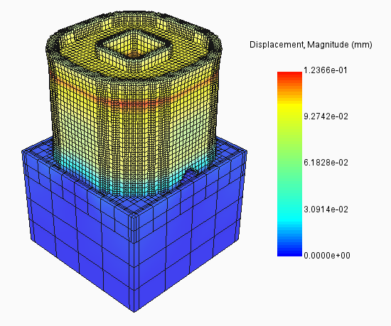

  18. When the simulation finishes, a dialog box prompts you to automatically import the results into Simulation Utility if desired. Choose Yes. The Results tab opens.
  19. In the Browser on the left side of the window, hide the Geometry and Build plate by clicking the light bulbs next to them so they go from on () to off (). Turn on the light bulb for Displacement results.
  20. Play through the results using the Play button or other Animation controls, stopping on the final Index of the simulation. By default, the legend normalizes to the current minimum and maximum result.

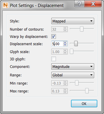

  21. To make the displacement results more visible, click Plot Settings .
  22. In the Displacement scale box, change the value to 5, then click OK. This warps the part by the predicted displacement and magnifies the effect 5 times, which makes it easier to observe the changes in geometry caused by thermally induced plastic distortion.
