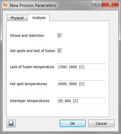

  3. In the New Process Parameters dialog, click the Analysis tab.
    By means of the two check boxes at the top, you can specify the type of PRM file to create: for Stress and distortion analysis, Hot spots and lack of fusion analysis, or both. If you select both, the PRM file in the library will have a combination icon . The three temperature fields at the bottom of this dialog are active only if you select Hot Spots and Lack of Fusion. The temperatures which should be set for this type of PRM generation are:
    Lack of fusion temperature - This specifies the temperature(s) below which the part will not fully fuse, typically the Liqudius temperature, Solidus temperature, or both. The reported result from this during part level thermal simulations is an indication of what percentage of each element is likely to fall below that temperature. For conservative models, use temperatures lower than the Solidus temperature of that material.
    Hot spot temperatures - This specifies the temperature(s) which if exceed may result in poor build quality. The results of the ensuing part level simulation depicts what percentage of each element is likely to be above each hot spot temperature.
    Interlayer temperatures - The specifies which interlayer temperatures should be investigated during PRM generation. More temperatures create a finer level of prediction, but each additional temperature will add computational time.
    Best practices - To determine what interlayer temperatures are necessary it is suggested that the part level geometry or geometries that are of interest for that combination of processing conditions are simulated using a standard stress and distortion PRM and choosing the Thermal Only Analysis type in the Solver Settings menu. Determine from the simulation(s) the peak temperatures that may be experienced. This should be used for the upper interlayer temperatures, rounded up to the next 100°C. The lowest temperature should be set to the ambient temperature, typically 25ºC. To determine what other temperatures should be used, plot the thermal properties of the material in question with respect to temperature. Add additional interlayer temperatures where observable non-linearties occur.

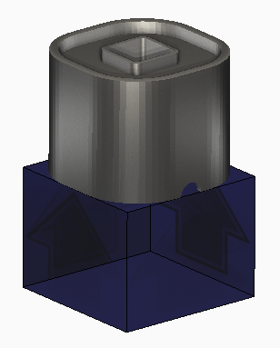

  5. To start an analysis, click Simulation menu > Open, browse to the sample folder Example_16 and open the model Example_16.tivus.

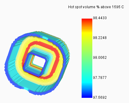

  10. Select Hot Spot results, and note that the hot spot and lack of fusion analysis makes use of the finest possible mesh, showing no adaptive coarsening.
    Tip: To improve visibility of results, right-click any result, select Render Properties, then in the dialog, uncheck Element Edges.
    Hot spots are most likely to appear in the thickest part of the build material, and that is the case here.

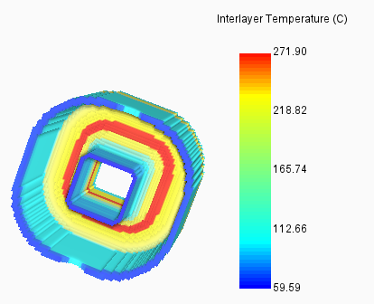

  11. Select Interlayer Temperature results to see the temperature of each layer just before the next layer was added. Again, the highest temperatures appear in the thickest part of the build.

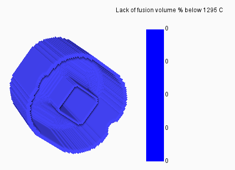

  12. Select Lack of Fusion results.
    You can see that this simulation predicts no lack of fusion in the build, below 1295° C.
