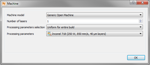

  2. Click Home tab > Machine to open the Machine dialog.
  3. In Processing Parameters, select the Inconel 718 PRM file.

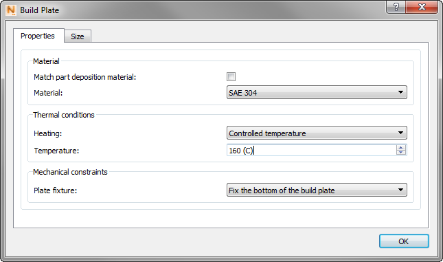

  4. Click Home tab > Build Plate.
    Deselect Match Part Deposition Material, and in the Material menu, select SAE 304 stainless steel, which is commonly used with Inconel powder.
  5. Under Thermal conditions, Heating, select Controlled temperature.
  6. In the Temperature box type 160 (C).
  7. Click OK.

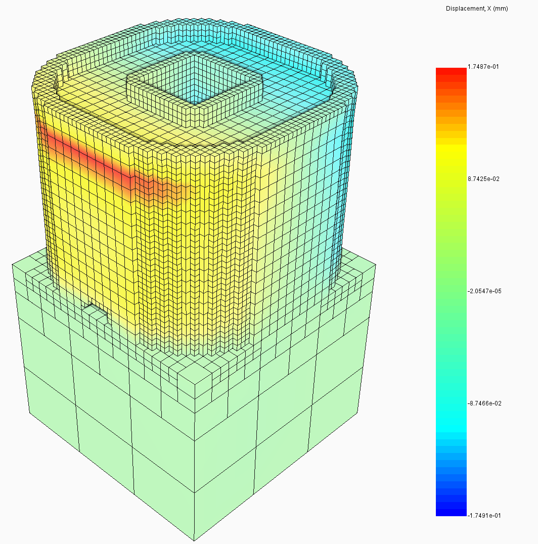

  11. Select the top Solve option to run the simulation on your computer:
  12. When the simulation finishes, a dialog box prompts you to automatically import the results into Simulation Utility if desired. Choose Yes. The Results tab opens.
  13. To compare the displacements to experimental results, click Plot Settings .
  14. In the Components dropdown menu, change the value to X, then click OK.
    The peak distortion predicted using the generic Inconel 718 PRM file is 0.17 mm which is much lower than the experimentally measured 0.40 mm. The model-measurement correlation can be improved by scaling the PRM file.

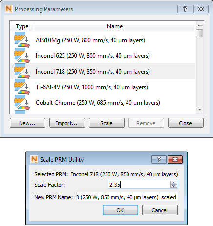

  15. Return to the Home tab and open the Processing Parameters dialog.
  16. Select the generic Inconel 718 PRM file provide with Simulation Utility for Netfabb and choose Scale.
  17. Assuming the scaling for this part's distortion is linear the Scaling Factor should be the measured distortion divided by the predicted distortion, which in this case is 0.40 mm/0.17 mm = 2.35. Enter 2.35 into the Scaling Factor box. Press OK.
  18. The scaled PRM file will be added to the Processing Parameter library. To simulate the part with the scaled PRM return to the Machine dialog. On the Processing parameters dropdown select the newly scaled PRM file, which should be the last on the list.

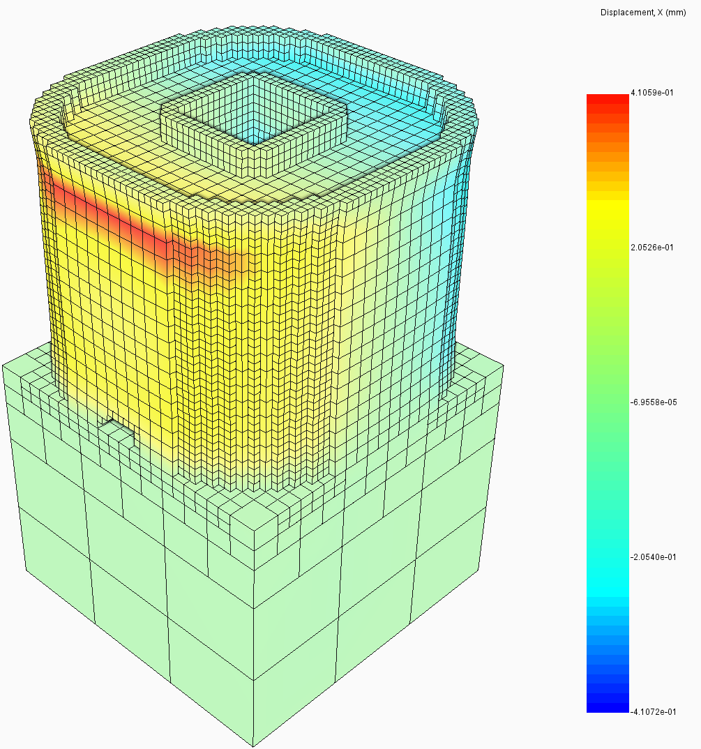

  19. Click Solve again. When prompted to overwrite previous results, select OK to proceed.
  20. Auto-import the new results.
    Remember: To see the correct displacement results, on the Results tab, click Plot Settings and set the Component value to X, as you did for the first simulation results.
    Using the scaled PRM file attains model results within 1% of the actual measurements. This scaled PRM file can then be used to perform simulations of this material and processing parameter combination with confidence in the accuracy of the predicted distortion.
