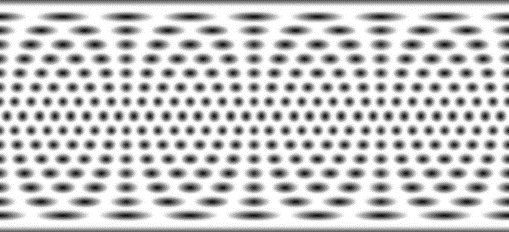

  1. Color or texture your part. If using a texture, it is best to use a grayscale image.
  2. Switch to the Extrude tab in the context area.

  4. Adjust the White Movement and Black Movement as necessary to control how the white, black, and gray areas will be extruded. A positive value pulls the colored area out of the original geometry. A negative value subtracts the colored area from the original volume.
  5. Choose the Extrude Area. If your texture is wrapped around the entire part, select Whole Part. If your texture is only applied to a specific area on the part and you don't want to apply the extrusion to the entire part, select the directory of the image.
