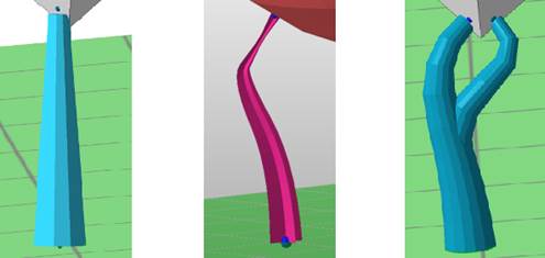

Bar contour Notes
Bar contour
The type of structure.
From left: Straight bar with a solid contour; curved bar with right angle on the part, a cross-shaped cross section, and a breaking point; curved and solid bar with bouquet structure.
Cross, Solid Bar, Solid Cross

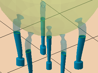

Breaking point
Generates a section where the bar narrows and expands to create a defined breaking point near the part surface, making it easier to remove supports from the part later on.
Notes
Breaking point
Toggle yes or no to activate the breaking point.
Breaking point width
Defines the strength of the bar at the breaking point. It will be easier to remove the bar with a thinner breaking point.
Width on end
Making the part wider at the end of the breaking point can increase adhesion of the bar to the part.
Breaking point height
Determines the distance between the anchor point on the part and the kink on the breaking point.
Height on start
Determines the length over which the breaking point reduces to its center.
Height on end
Determines the length over which the breaking point expands back to the original width, or the width of the end on the part.
Right angle on part
Determines whether bars should make a small curve to terminate in a right angle at the supported surface, rather than terminating at whatever angle they would otherwise have.
Distance to right angle
Determines the distance away from the supported surface after which the bar starts to curve towards the other end.
Smoothing distance
Determines the length of sections that form the curve. The shorter the section, the finer the curve is resolved, resulting in a smoother transition but also increased triangle count.
Pad on platform
A pad is a widened cross section at the platform end of a bar support to reinforce adhesion to the platform surface
