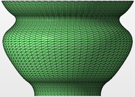

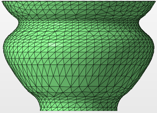

  5. Click Calculate to produce a preview of the new mesh.
  6. Enable the Show Triangles check box to display the mesh edges.
  7. Click and hold Show Original Mesh to see original mesh before the triangle reduction.

  10. Click OK to apply the triangle reduction.
