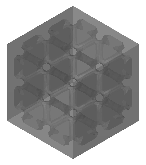

Generate cavities for a solid part, and apply a lattice to them
  1. Select a part from the project tree.
  2. From the menu, choose Modify >  Lattice Assistant.
  3. In the context area, choose the Hollowing tab.
  4. Adjust the presented settings as needed. Click Calculate to see a preview of the latticed cavity.
  5. Click Apply.
  6. From the appearing dialog, make your choice regarding keeping or discarding the original part.
The part is now hollowed and latticed as specified.
Calculated lattice in a hollowed cube
