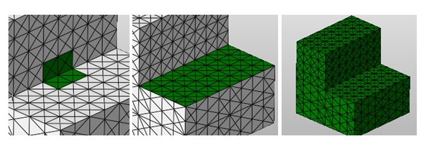

    • Select Triangles: Selects individual triangles.
    • Select Surfaces: Selects entire surfaces.
    • Brush Selection: Selects individual triangles by painting over them with a brush.
    • Select Shells: Selects entire shells.
    • Tip: Hold the Ctrl key and click on a triangle, surface, or shell to add entities to or remove entities from the selection. If you hold the Ctrl key and move your mouse around the display, entities are added to or removed from the selection.
Left: Selected triangles. Center: A selected surface. Right: A selected shell.

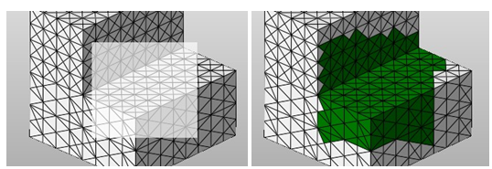

  4. Choose a primitive selection shape. Available options are Rectangle or Circle.
  5. In the display, click and drag with the mouse to create the primitive shape.
Left: Drag a primitive shape. Right: The resulting selection.
