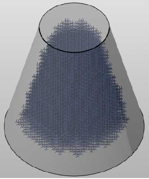

The first script example automatically executes the following working steps in the 3S module.
- Getting volume data: The information of the volume data in the 3S Generator is loaded into the script, referred to as
volumedata.
- Getting Cell: The cell with the name
diamond is loaded into the script and is referred to as
cell.
- Initializing: The part is cleared of all fragments.
- Rastering the part: The part is gridded and a new fragment is created, overwriting all other fragments within the part. The new fragment is referred to as
fragment in the script.
- Create Shell: A hull of the fragment is created with the parameter
3 for all axes and all directions. The hull fragment is referred to as
hull.
- Assign cell: The structure cell
cell is assigned to the core fragment
fragment.
- Final Cleanup: All empty fragments containing no more grid cells are removed.
- Create Simulation: After execution of the script, a simulation of the part is created.
