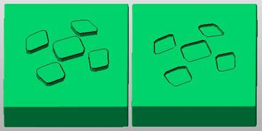

  8. Choose a build type from the drop-down menu. Available options include:
    • Add to Part: Makes the label stand out from the part.
    • Add to Part (inverted): Makes the label stand out from the part, but flips the text which can be useful for mold making.
    • Subtract from Part: Engraves the label into the part surface.
    • Subtract from Part (inverted): Engraves the label into the part surface, but flips the text which can be useful for mold making.
