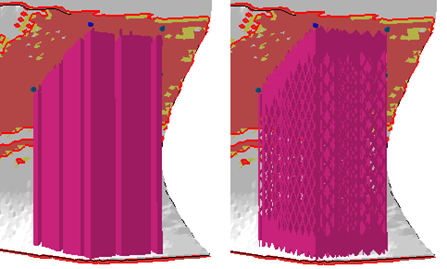

Volume supports are hollow, regular structures similar to pipes with a square cross section. To create volume supports, you must define at least three anchor points to form an area that can have volume supports applied. Line types, structure properties, fragments and connection types can be adjusted.
Left: Solid volume supports divided into fragments. Right: Volume supports built from a patterned structure.
Filling Type |
Switch the support walls between Hollow (solid) and Structured.
![]() Applied default hollow supports. A cut via clip plane demonstrates the cluster's contour, the fragments' cross section, the terminating surface at the top, and the stand-off against the part surface. ![]() Applied default Structured supports. Note the gap in the circumference. |

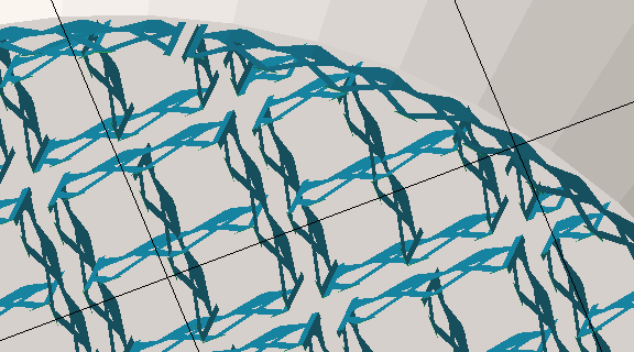

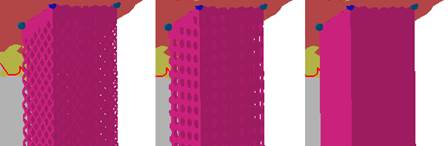

Structure pattern |
Switch between Wired wall (left), a Punched plate (middle), and Solid (right) to determine the wall pattern of volume supports.
Width and height |
Width and height of the hole shapes for Wired wall and Punched plate. |
Interval width and height |
Distance between neighboring holes to the sides and to those above and below. |

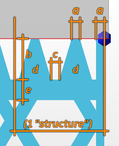

| Connection property | |||
Connection |
Type of connection |
Select from: Strip, Trapoid, Breaking Points, Triangles.
Connection width |
a |
![]() Connection properties |
Connection height |
b |
Pin distance |
c |
Pins per structure |
d |
Distance connection to structure |
e |

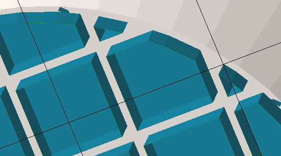

| Fragments | Fragmentation of volume supports into individual blocks makes it easier to break the supports from the part. |
Raster |
Fragments |
Turn fragmentation on or off. |
Fragment size X |
Fragment size in X direction. |
Fragment size Y |
Fragment size in Y direction. |
Fragment gap |
Describes the distance between two fragments. |
X shrinkage |
Shrinks the fragment at the bottom end of the x axis, to have a wider fragment at top, whose size decreases to the set value |
Y shrinkage |
Shrinks the fragment at the bottom end of the y axis, to have a wider fragment at top, whose size decreases to the set value |
Contour |
Fragment contour |
The cluster-enveloping contour can be fragmented as well, using this toggle. |
Fragment contour length |
Defines the length of a fragment unit. |
Fragment contour gap |
Defines the gap between two fragment units |
