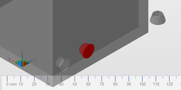

The part now has perforations added, and any generated plugs have been added to the buildspace as new parts.
A hollow cube with one calculated hole and plug, as well as the hole stencil placed at a different position.
