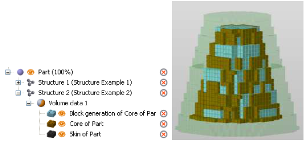

Example 2
Example 2 is similar to Example 1, but contains one more cell and an additional fragmentation operation.
-- This is like Example 1
volumedata = structure:findvolumedta ("volume data 1");
cell1 = structure:findcell ("cell small");
cell2 = structure:findcell ("cell large");
volumedata:reset ();
fragment = volumedata:addmeshtoraster ();
hull = fragment:createhull (3,3,3,3,3,3);
-- divide blocks off
blocks = fragment:divideblocks (2,2,2,0,0,0);
-- assign cell
fragment.cell = cell1;
blocks.cell = cell2;
-- final cleanup
volumedata:cleanup ();
structure.simulateafterexecution = true;
