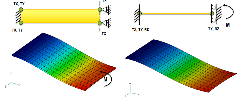

  • Use symmetry in the model to constrain the rigid body motion. This method reduces the model size while naturally adding the needed constraint!
Symmetry constrains the "plane normal" translations and "in-plane" rotations:

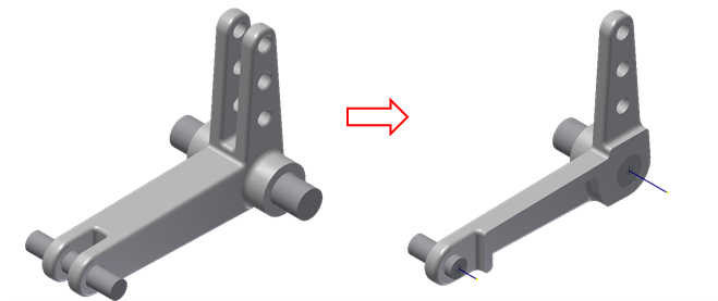

Start Autodesk Inventor, and open the file Lever-Pins.iam from the Section 10 - Contact & Symmetry sub-folder of your training exercises folder. Note that the model has been cut in half with an extrusion cut. This is valid because the geometry on either side of the plane of symmetry is exactly the same:

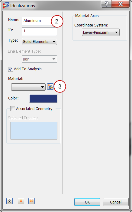

2. Assign the Physical Property to the Lever Arm

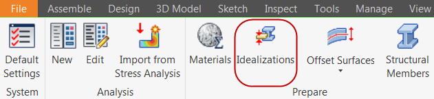

  1. From the Properties panel of the ribbon, click Idealizations.
  2. On the Idealization dialog, enter the name Aluminum.

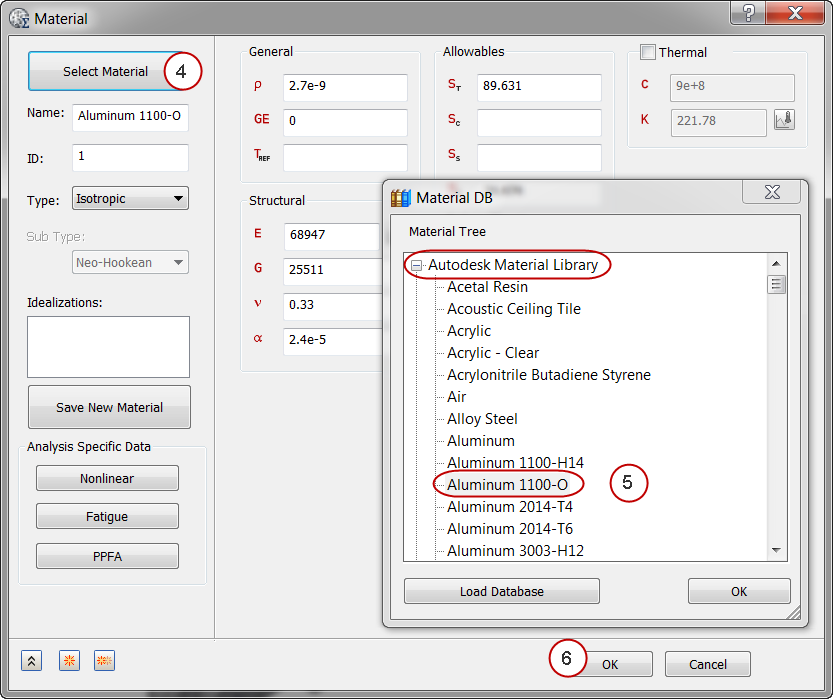

  3. Click the New Material icon.
  4. On the Material dialog, click Select Material.
  5. On the Material DB dialog, expand the Autodesk Material Library, and select Aluminum 1100-O. Click OK, and ignore any messages about Failure Theory.
  6. Click OK on the Material dialog.

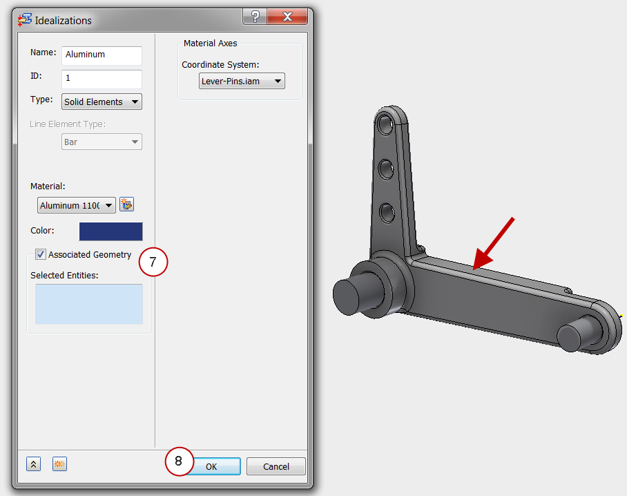

  7. On the Idealizations dialog, check Associated Geometry, and select the Cast Lever part.
  8. Click OK.

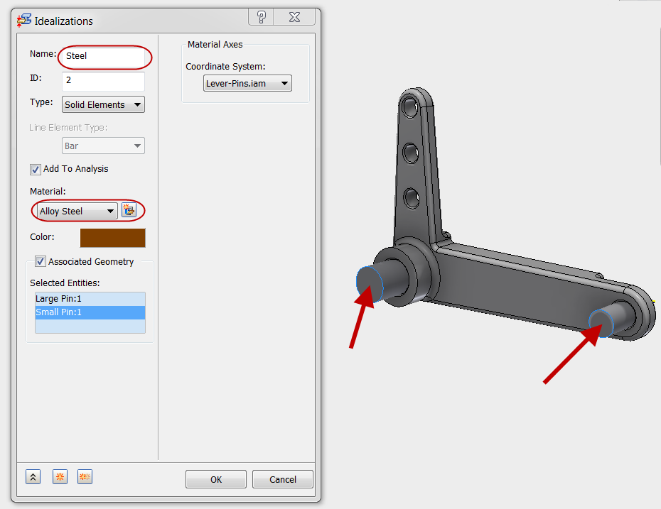

3. Assign the Physical Property to the two Pins
Click Idealizations in the ribbon and repeat the procedure in the previous step, with the following changes:

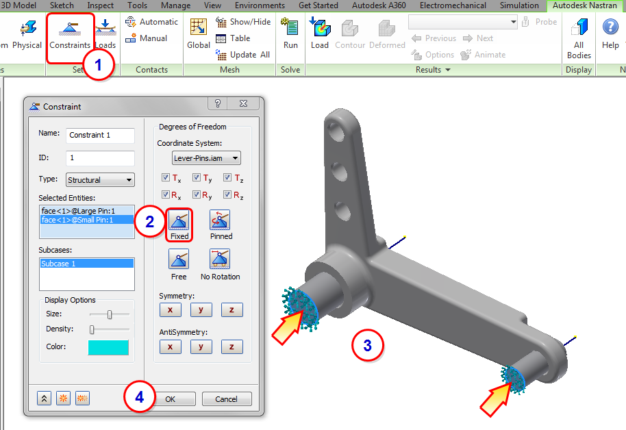

  1. Click Constraints from the Setup panel of the ribbon.
  2. Click the Fixed button on the Constraint dialog.
  3. Select the end surface of the two pins.
  4. Click OK.

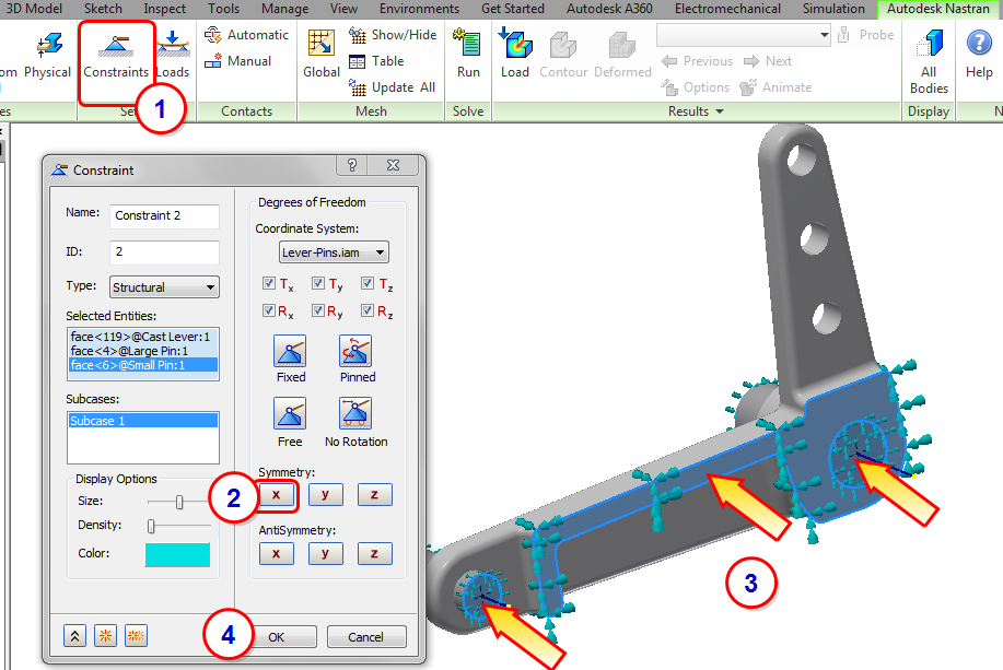

5. Assign the Symmetry Constraint
  2. Click the X Symmetry button. (Note that the normal to the plane of symmetry is in the x-direction. Choosing X Symmetry constrains Tx, Ry, and Rz.)
  3. Select the three faces on the symmetry plane. (Be sure to select the surface on the lever and one on each pin.)
  4. Click OK.

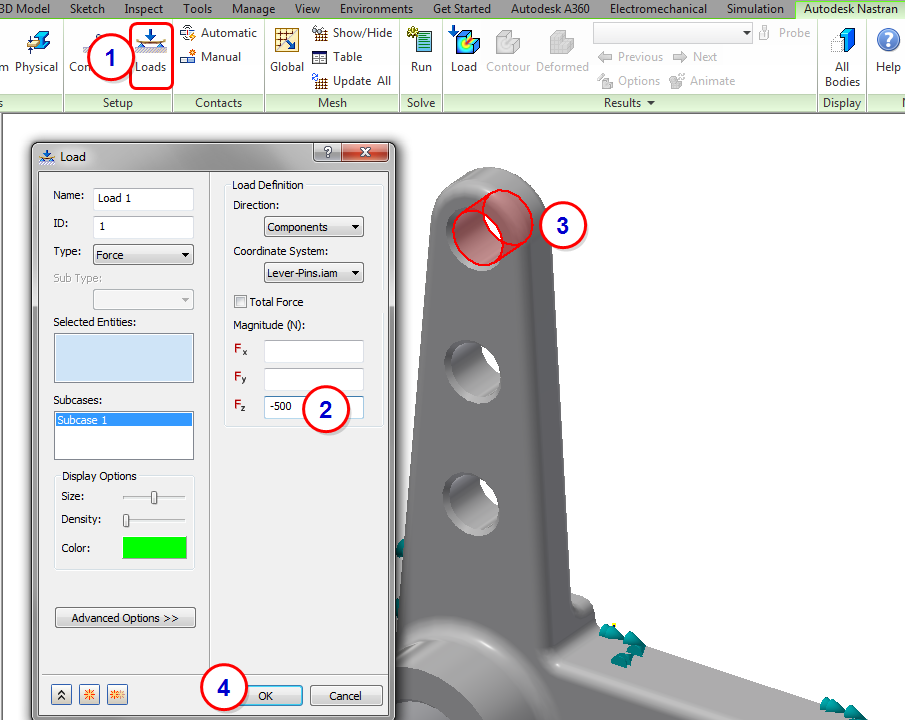

6. Assign the Load
  1. Click Loads from the Setup panel of the ribbon.
  2. Enter a load of -500 for Fz. (Because we are using half symmetry, we only need half of the original load.)
  3. Select the inside surface of the top-most hole.
  4. Click OK.

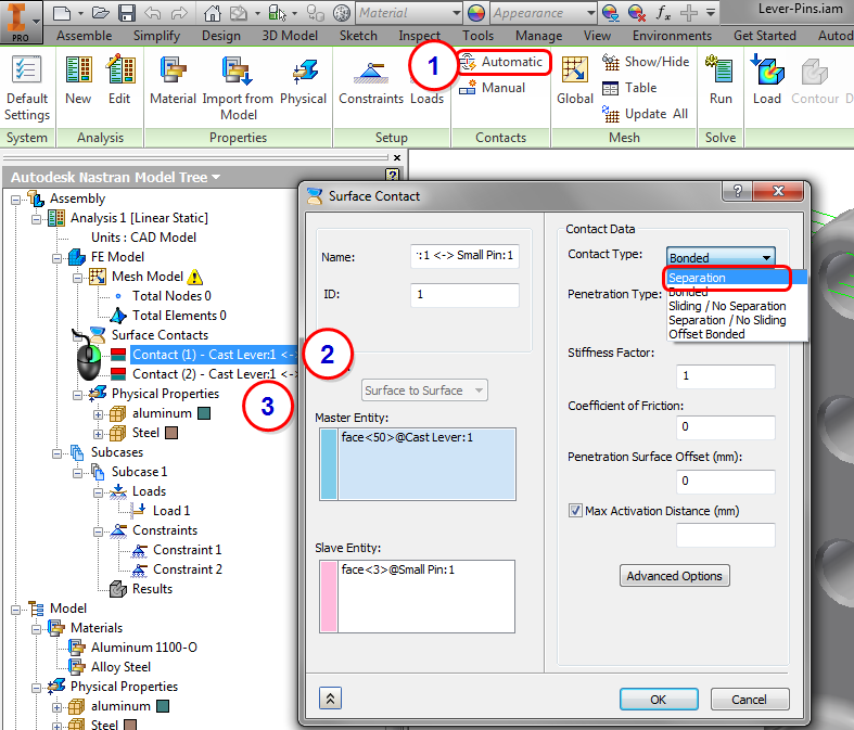

7. Assign Contacts
  1. On the Contacts panel of the ribbon, click Automatic. This automatically identifies and assigns the surface contact pairs throughout the assembly.
  2. The default contact type is Bonded. However, for this assembly, we want to allow for some movement. To change the contact type, on the Analysis tree, expand Surface Contacts, right-click the first contact in the tree, and click Edit. In the Surface Contact dialog, change Contact Type to Separation, then click OK.
  3. Repeat with the other contact.

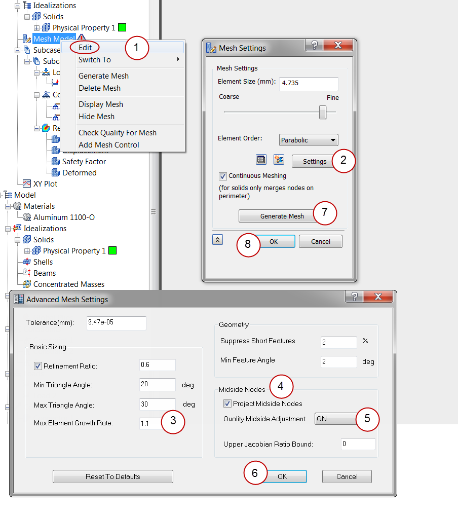

8. Mesh the Model
  1. On the Analysis tree, right-click Mesh Model > Edit.
  2. In the Mesh Settings dialog, click Settings.
  3. On the Advanced Mesh Settings dialog, change the Max Element Growth Rate to 1.1.
  4. Check the Project Midside Nodes box.
  5. Set Quality Midside Adjustment to ON.
  6. Click OK to close the Advanced Mesh Settings dialog.
  7. Click Generate Mesh.
  8. Click OK to close the Mesh Settings dialog.

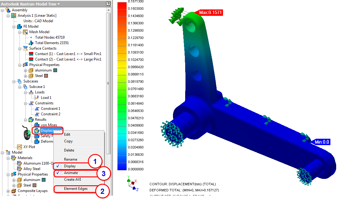

10. Review Displacement Results
  1. From the Results branch of the tree, right-click on Displacement, and click Display.
  2. To hide the element edges, right-click again on Displacement, and uncheck Element Edges.
  3. To animate the displacement, right-click again on Displacement, and check Animate.

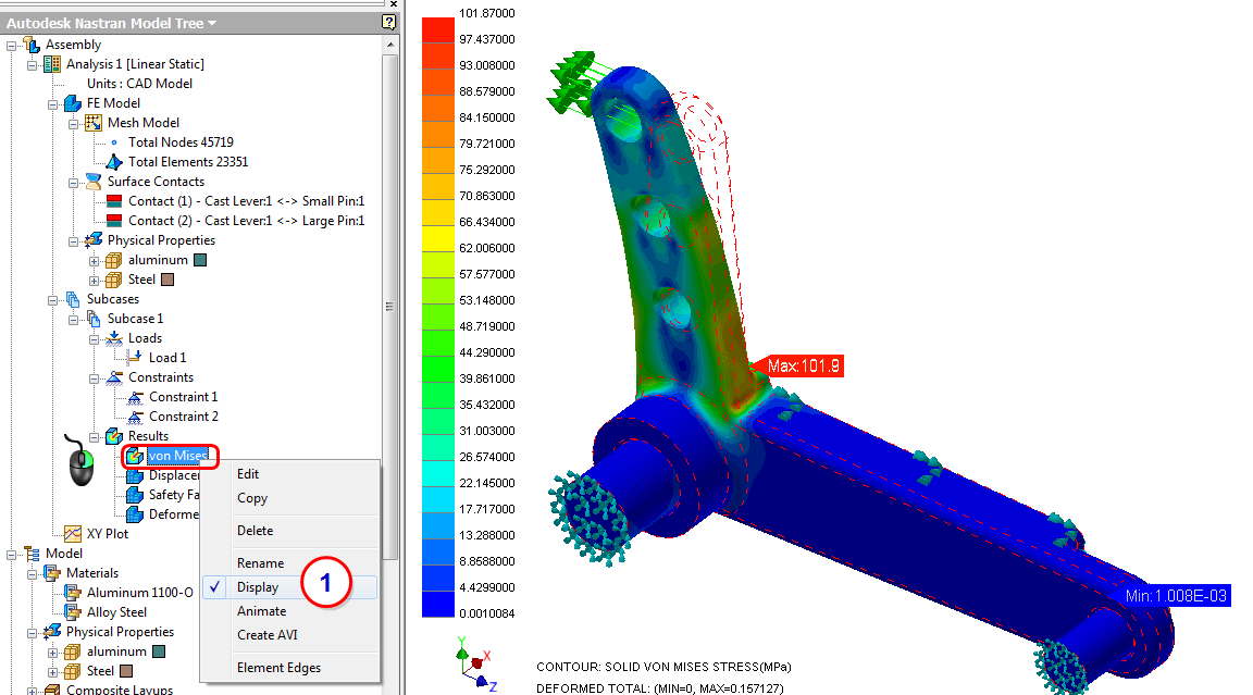

11. Review the Stress Result
  1. From the Results branch of the tree, right-click on von Mises, and click Display.

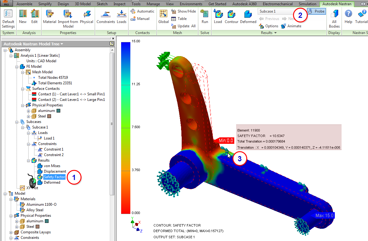

12. Review the Safety Factor Result
  1. From the Results branch of the tree, right-click on Safety Factor, and click Display.
  2. To determine the exact value of safety factor at a specific location, click the Probe command on the ribbon.
  3. Hover over the model.
