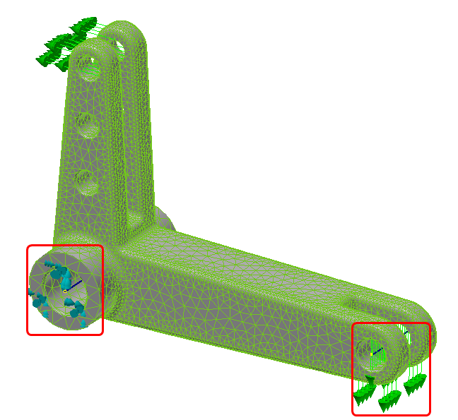

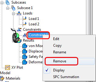

We need to remove the constraint and the load at the end of the lever, as shown below:
To remove the constraint, right-click on the constraint in the Tree, and select Remove:
To remove the load, right-click on the load in the Tree, and select Remove. Be sure the select the correct load by ensuring that the desired condition highlights in the model, as shown above:

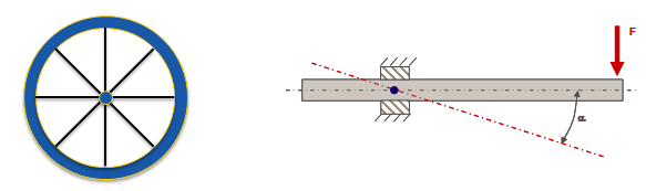

Info: Ball Joint Constraints
A commonly used technique in FEA is the 'ball joint' constraint to control rotations. The ball joint constraint uses rigid elements to control a reference point. The rigid elements are often called 'spokes' or 'spider webs', given their appearance. We tie the movement of an edge or surface to a reference point to allow for more natural movement. In Autodesk Nastran In-CAD, this is done with a Rigid Connector:

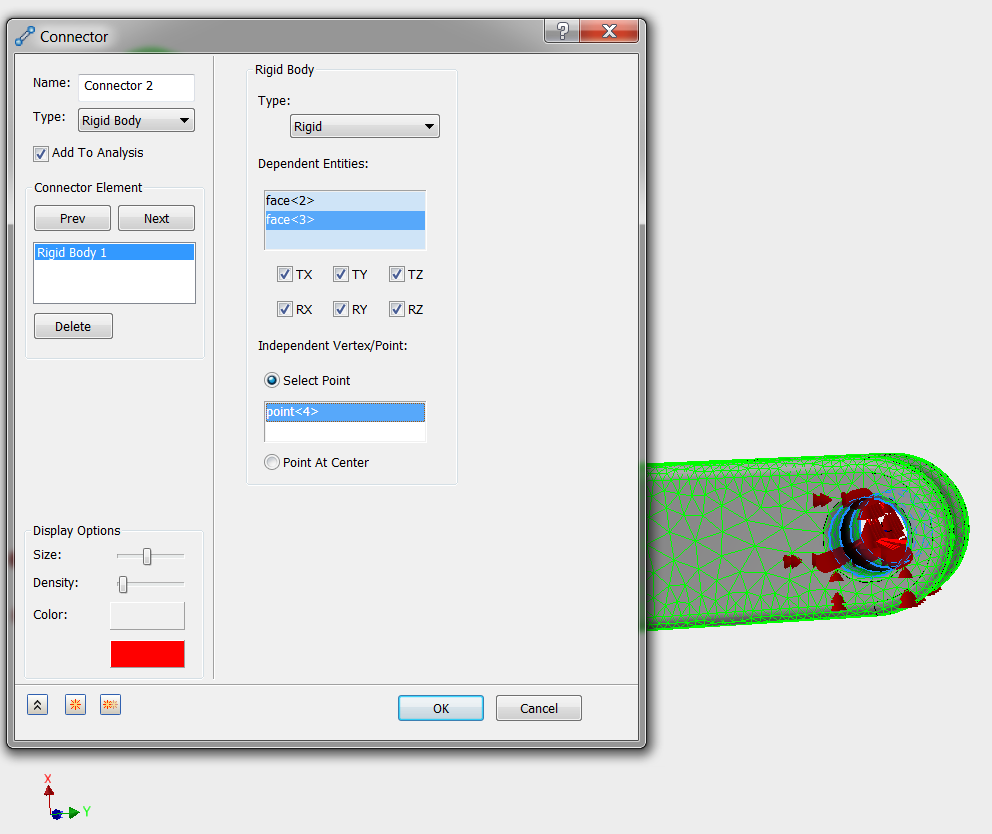

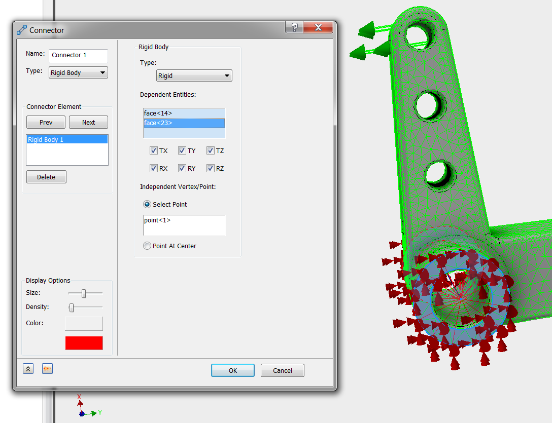

2. Create the First Ball Joint Constraint
  1. From the Model tree, right-click Connectors > New.
  2. In the Connector dialog, set the Type to Rigid Body.
  3. Click the Independent Vertex/Point field to activate it, then select the reference point on the axis as the Independent Vertex.
  4. Click the Dependent Entities field, then select the two end faces of the lever as the Dependent Entities.
  5. Make sure all degrees of freedom are checked.
  6. Make sure the RigidBody Type is set to Rigid.
  7. Click OK.
3. Create the Second Ball Joint Constraint
Repeat the procedure to create the ball joint constraint on the small hole. For the Independent Vertex, select the reference point on the axis. For the Dependent Entities, select the inner diameter surface from each hole, as shown:

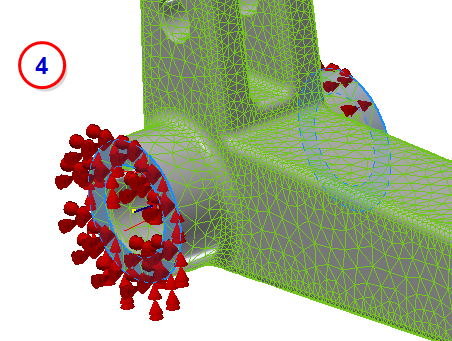

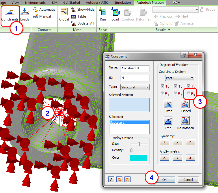

4. Constrain the Pinned Holes
  1. Click Constraints from the ribbon.
  2. Select the reference point at the center of the large pin.
  3. On the Constraint dialog, uncheck the Rz degree of freedom.
  4. Click OK.

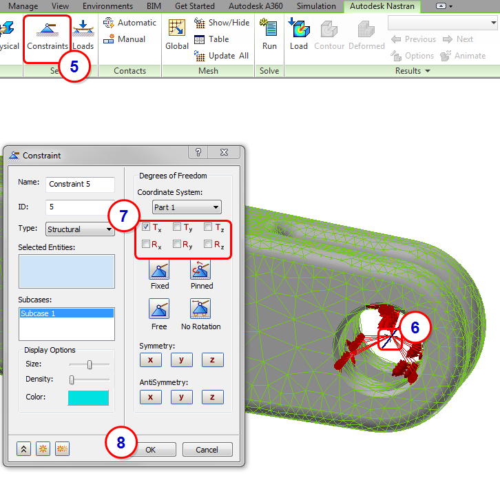

  5. Click Constraints from the ribbon again.
  6. Select the reference point at the center of the small hole.
  7. Uncheck all degrees of freedom, except for Tx.
  8. Click OK.

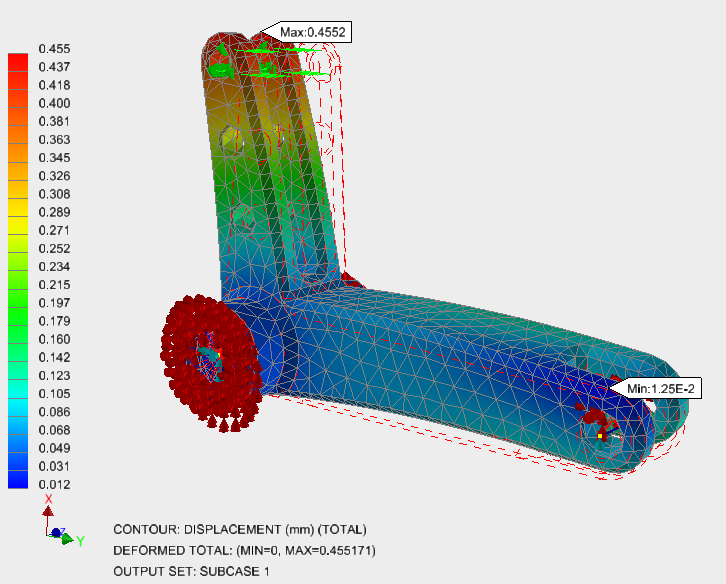

5. Run the Model and Review the Displacement Results
  1. Click Run from the ribbon. The analysis runs, and status messages appear in the Autodesk Nastran Output window.
  2. When the run is complete, click OK on the message box that indicates that the solution is complete.
  3. To plot displacement, right-click on Displacement from the tree, and click Display. You should see this:
  4. To animate the displacement, right-click on Displacement, and click Animate.
  5. To stop animation, right-click on Displacement, and click Animate so that it is unchecked.

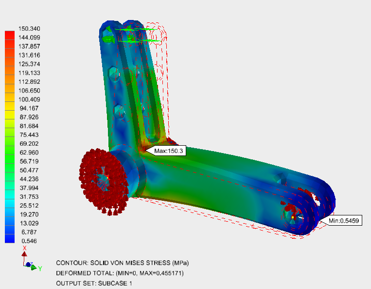

6. Review the Stress Results
To plot von Mises stress, right-click on von Mises from the tree, and click Display. To hide the element edges, right-click von Mises > Edit , and in the Plot dialog, click Visibility Options and then Element Edges.

We replaced clearly incorrect loads and constraints with advanced techniques that produced a much more realistic deformation.

Even with the improved boundary conditions, the controlling stress did not change appreciably. This should NOT be taken to mean that stress is insensitive to boundary conditions. It is, and this was simply a coincidence of this particular model.
