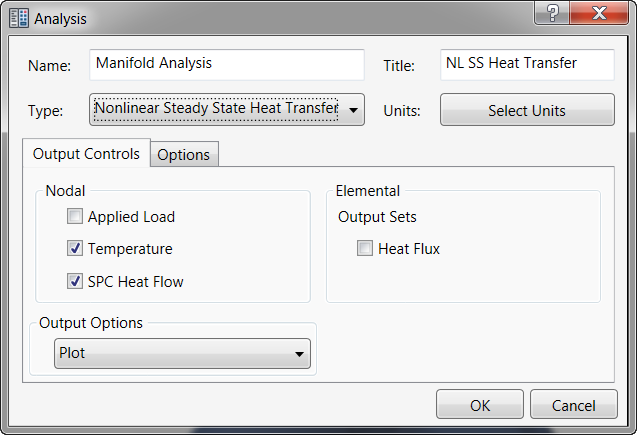

- In the tree view, right-click on
Analysis 1 and choose
Edit.
- Type
Manifold Analysis
for
Name, and
NL SS Heat Transfer
for
Title. Select
Nonlinear Steady State Heat Transfer from the
Type drop-down menu.
- The dialog should look as shown below.
- Click
OK to finish setting up the analysis and return to the tree view. The model is now ready to be analyzed.
