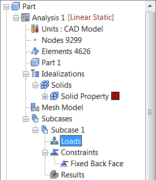

You can also drag-and-drop different entities in the tree view. For example, the
Axial Loading
load and the
Fixed Back Face
constraint can be dropped on top of the
Subcase 1 name.
You can hide the loads and constraints.
Click on
Autodesk Nastran menu tab on the top of the CAD interface, and then choose
Default Settings under the
System panel on the ribbon. Then click
Display Options and uncheck the
Loads and
Constraints checkboxes. They can also be hidden by right-clicking on the
Loads or
Constraints within the
Subcases section in the tree and checking
Hide All.
