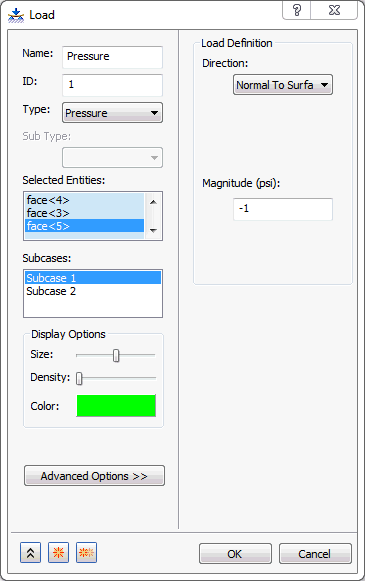

  1. Right-click on Loads under Subcase 1 and choose New.
  2. Change the Name to Pressure.
  3. Change the Type drop-down to Pressure. Type -1 for Magnitude under Load Definition.
  4. Be sure that Subcase 1 is selected in the Subcases list. Do not select Subcase 2 because it is for the eigenvalue analysis.
  5. Select all the surfaces in the model, either individually, or by using a box pick method.
  6. The Load dialog should look as shown below.

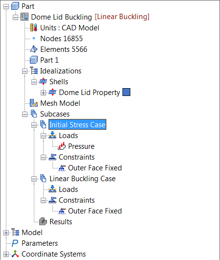

  8. In the Part tree, right-click on Subcase 1, select Rename and type in Initial Stress Case.
  9. Right-click on Subcase 2, select Rename and type in Linear Buckling Case.
  10. Once finished, the tree view should look as shown below.
