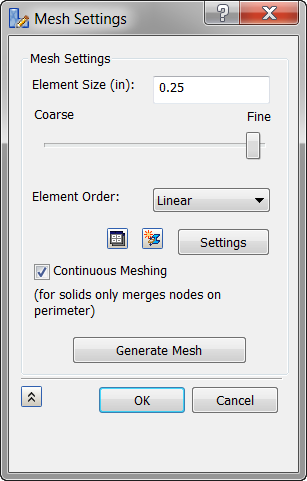

There are two ways to edit the model mesh settings:
Mesh Setings option is activated).
The Mesh Settings form in the figure below comes up, since this is the default selection for the Edit command.
): This icon allows you to switch from the global
Mesh Settings to the
Mesh Table.
): This icon allows you to create a new Idealization.
