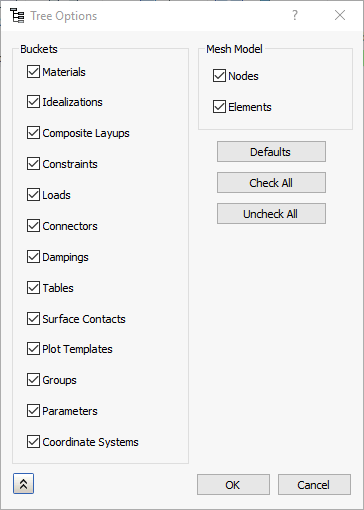

Tree Options is used to eliminate items from the model tree that are not desirable to view.
Upon clicking on Tree Options the following dialog will appear.
When an item is unchecked within the dialog it will be removed from the tree. The Defaults button will check off only those items that are absolutely necessary. Check All will check all boxes, and Uncheck All will uncheck all boxes.
