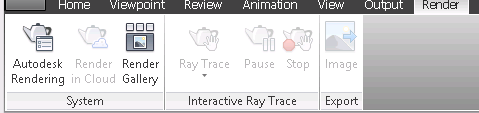

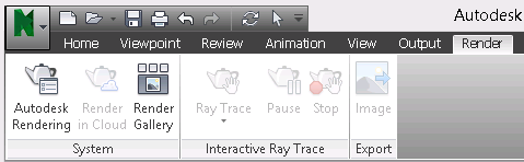

The Autodesk Rendering tools can be accessed from both the Home tab
Tools panel and the Render tab on the ribbon.

Render Style panel), and for the photorealistic visual style (controlled with the Ray Trace
button on the Render tab
Render panel).
