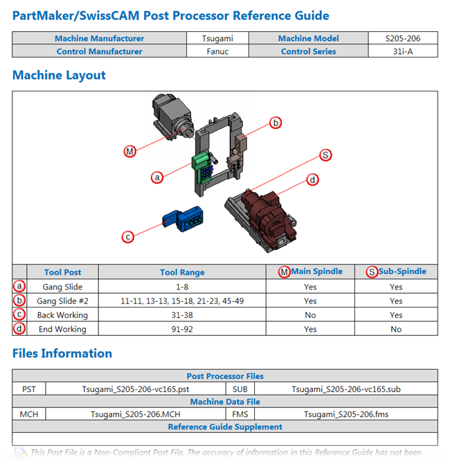

PartMaker creates all Post Processor Reference Guides as .html files, but you can choose to view them in a web browser or in Microsoft Word.
PartMaker creates and displays the Post Processor Reference Guide. For example:
