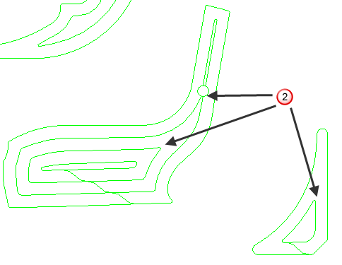

On the High Speed page:
Profile smoothing — selected
Raceline smoothing — selected
Trochoidal moves — selected
Maximum overload of 10%
Links — Smooth
When the tool approaches overload, a trochoidal path is inserted to avoid the overload.
— Narrow channel
— Sharp corner

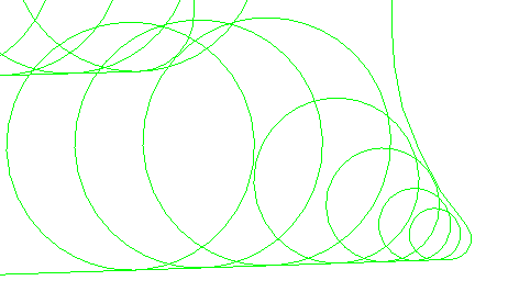

Looking in at a corner in even more detail, you can see the trochoidal path more easily:
