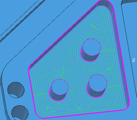

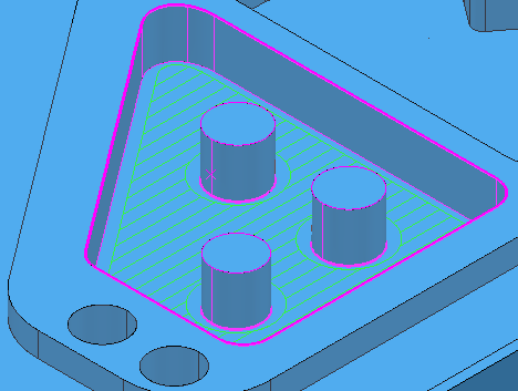

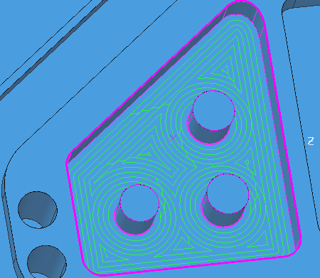

Flat style — Select the raster or offset style to use for removing material.
Select a Style from the following:
This produces a toolpath which:
but increases the number of tool lifts.
