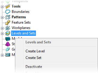

Use the Levels and Sets menu to create and manage levels and sets in the current project.
To display the menu, in the Explorer, right-click Levels and Sets.
Levels and Sets — The name of the menu.
Create Level — Select to create a new level
. The new level does not contain any entities until you move an entity onto the level using the Acquire Selected Model Geometry option on the individual Level context menu.
Create Set —Select to create a new set
. The new set does not contain any entities until you move an entity onto the set using the Acquire Selected Model Geometry option on the individual Set context menu.
Deactivate — Select to deactivate the currently active level or set.
Draw All —Select to display all levels and sets
Undraw All — Select to undraw all levels and sets
Properties — Select to display information about all components used in all the levels and sets.
Delete Empty Levels and Sets — Select to delete all levels and sets which contain no entities.
Delete All Except Non-Empty Levels — Select to delete all the sets (whether they contain entities or not) and deletes all the levels which contain no entities. Only levels containing entities remain.
