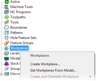

Use the Workplanes menu to create and manage workplanes in the current project.
To display the menu, in the Explorer, right-click Workplanes.
Workplanes — The name of the menu.
Create Workplane — Select to create a new coordinate system. The Workplane Editor tab controls the location and orientation of the new workplane.
Create and Orientate Workplane — Select to create a new coordinate system and specify the location and orientation of the workplane. These options are also available on status bar.
